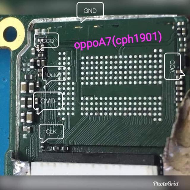

oppo a7 isp pinout
Ghanshyam
Mar 9, 2019
30
8
Oppo A7 Cph-1901 Remove Pin Lock And Frp Lock Done With Ufi-Box Offline Work
Remove User-Lock/Pin Lock
Remove Frp Lock
Ufi-Log Model Detail
After Remove Lock Set Working Fine
Pinout sir

sir im just a newbee do you have other photos that has exact point on?
pardon me i just need exact point like i said im begener i dont want to kill a phone -_-

pls help me, current oppo A7 CPH 1905 device dont read eMMC with boX UFI.
pls give solutions:
Connection status: XHCI:HUB3:USB 2.00 High-Speed
Interface: UFI High-Speed
Serial number: 0011-8841-7178
Boot version: 1.05, FW version: 1.13 (Aug 19 2019 23:46:09)
Insertion test... Done
VCCQ not properly connected
Init bus...
VCC: 3.3 V, VCCQ: 1.8 V
Bus: 1 bit (SDR 4MHz)
Access mode: sector mode
Product name: RH64AB (0x524836344142), rev: 0x05, serial number: 0x18F8688B
Manufacturing date: Dec 2018
CID: 15010052 48363441 420518F8 688BC51A
CSD: D0270132 0F5903FF F6DBFFEF 8E40400C
EXT_CSD revision: 1.8 (MMC v5.1)
Partition info:
Boot1: 4096 KiB
Boot2: 4096 KiB
RPMB: 4096 KiB
User area: 58.24 GiB(62,537,072,640 bytes)
