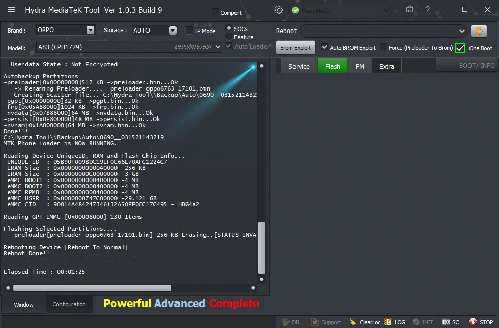

Hydra Oppo A83 (CPH1729) Partly flashed to remove FRP successfully done by Hydra Tool
549
Brand : OPPO Model : A83 (CPH1729) Connection : Flash Mode
How To Boot : Power off phone
* BROM Mode : Press VOL + or Press VOL -+
FriendlyName :MediaTek USB Port_V1632 (COM3)
SymbolicName :\??\USB#VID_0E8D&PID_0003#6&2b9c2bdb&0&2#{a5dcbf10-6530-11d2-901f-00c04fb951ed}
Handshaking...Ok
Identifying Hardware ID.....
BROM CPUID : 0690MT6763T[6763]
BROM HW_SW_VER : 8A00 CA01 0001 0000
getMTKPayloadExploit : 0690
#Executing Exploit..
#SUCCESS..
Handshaking...Ok
SECURE VERSION : 05
BL VERSION : FE
BR Secured : 00
NORMAL BOOT
Preparing Download Agent..
DA : 6763.bin
Ver : MTK_AllInOne_DA_v3.3001.2018-09-18.13:22_452898
Init : Loader [1]
Sending : Accepted
Identifying Protocol...
C0
Protocol : New
Synchronization...
SYNCSYNC
Mode : brom
Preloader Initialization...
Parsing preloader_oppo6763_17101.bin
Init : Accepted
Execute Secondary Loader
Init : Loader [2]
Executing : SYNC
UNIQUE ID : D5B90F009BDC19EF0C66E70AFC1224C7
eMMC CID : 90014A484247346132A50FE0CC17C495 - HBG4a2
DA Speed : high-speed
Reading System Info
Brand : OPPO
Vendor : OPPO
Model : OPPO A83js
SDK : 25
Release : 7.1.1
ABI : arm64-v8a
Locale : en-US
Description : full_oppo6763_17101-user 7.1.1 N6F26Q 1537620965 release-keys
Device : M6763D
Board : full_oppo6763_17101
Display ID : A83jsEX_11_A.21_180922
Security Patch : 2018-09-05
Platform : mt6763
FRPPST : /dev/block/platform/bootdevice/by-name/frp
StorageType : mtp
Autobackup Partitions
-> Renaming Preloader.... preloader_oppo6763_17101.bin
Creating Scatter file... C:\Hydra Tool\\Backup\Auto\0690__031521143219\MT6763T_Android_scatter.txt
-frp[0x05A88000]1024 KB ->frp.bin...Ok
-nvdata[0x07B88000]64 MB ->nvdata.bin...Ok
-persist[0x0F800000]48 MB ->persist.bin...Ok
-nvram[0x1A000000]64 MB ->nvram.bin...Ok
Done!!!
- preloader[preloader_oppo6763_17101.bin] 256 KB Erasing..[STATUS_INVALID_PARAMETERS]Failed Flash ->= Ok
Reboot Done!!
Elapsed Time : 00:01:25
