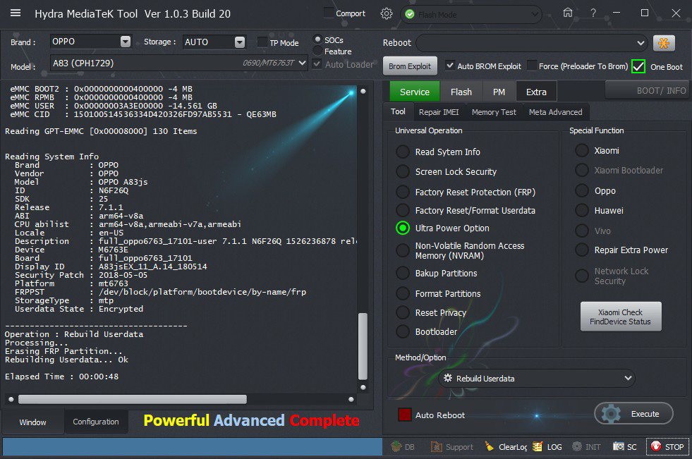

Oppo A83 (CPH1729) rebuilding user data successfully done by Hydra Tool
1. Run MTK Tool and choose "Sosc"
2. Choose Brand and Module.
3. Go to "Service"--> "Tool"
4. Choose "Ultra Power Option"
5. Choose "Rebuilt user data" from "Method / Option" drop down menu.
6. Connect device to computer using USB Data Cable.
7. Wait until the operation is completed.

Operation : Rebuild Userdata
Processing...
Erasing FRP Partition...
Rebuilding Userdata... Ok
Elapsed Time : 00:00:48
