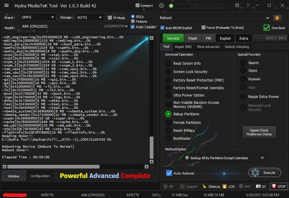

OPPO A94 (CPH 2203 ) Backup partition successfully done by Hydra Tool
1.Run Hydra MTK Module.
2. Choose Brand and Module.
3. Go to "Backup Partition"
4. Choose "Backup All the partition except user data" if you don't need user data from drop down menu.
5. Click on "Execute"
6. Connect device with computer using USB Data cable
7. Wait until the operation is completed.
Screen Shorts
Logs

Reading Done!!!
C:\Hydra Tool\\Backup\Full\__0725--()_200521165930 Ok
Reboot Done!!
Elapsed Time : 00:09:00
