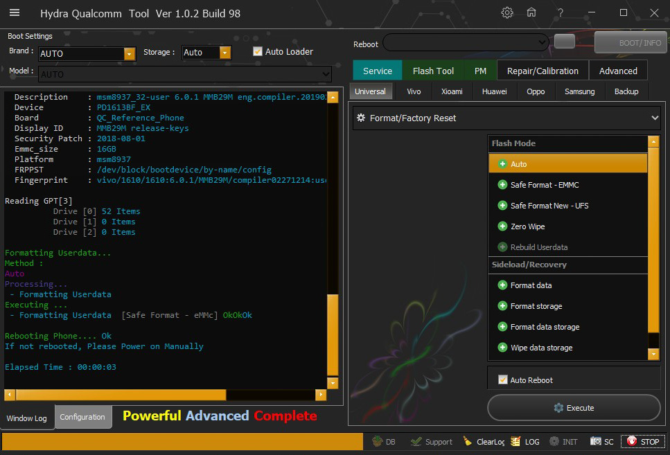

Oppo F1 factory format successfully done using flashing mode by Hydra Tool
1. Run Qualcomm Tool.
2. Choose Brand and Module.
3. Go to "Service"--> "Universal"
4. Choose "Format / Factory Reset" from drop down menu.
5. Choose "Auto" from flash mode.
6. Connect device to computer using USB Data Cable.
7. Click "Execute"
8. Wait until the operation is completed
