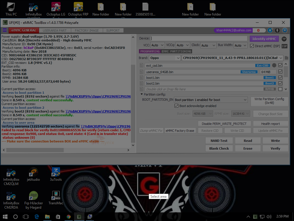

ask someting i have recieve again oppo chp1911 pasword problem when i reset setting frp after finish to do it via ufi the phone must be dead pls help me how to revive the phone pm

Write exd_csd file only device will bootup normaly

logs
Connection status: XHCI:HUB3:USB 2.00 High-Speed
Interface: UFI High-Speed
Serial number: 0011-8842-3903
Boot version: 1.05, FW version: 1.13 (Aug 19 2019 23:46:09)
Insertion test... Done
VCCQ not properly connected
Init bus...
VCC: 3.3 V, VCCQ: 1.8 V
Bus: 1 bit (SDR 12MHz)
Access mode: sector mode
Manufacturer ID: 0x90 (SK Hynix)
Product name: hC8aP (0x68433861503e), rev: 0x03, serial number: 0xCAD345F0
Manufacturing date: Nov 2018
CID: 90014A68 43386150 3E03CAD3 45F0B5DC
CSD: D0270032 8F5903FF FFFFFFEF 8E400042
EXT_CSD revision: 1.8 (MMC v5.1)
Partition info:
Boot1: 4096 KiB
Boot2: 4096 KiB
RPMB: 16384 KiB
User area: 58.24 GiB(62,537,072,640 bytes)
Current partition access:
Access to boot partition 1
Loading file: "\\C:\Users\NajiebAppleMujaAisah\Desktop\New%20folder%20(5)\(-9-PPR1.180610.011)[DV6DMB_856C6871]\boot1.bin", size: 4 MiB...
Writing boot1 (8192 sectors)... Done in 3.006 s
Access to boot partition 2
Loading file: "\\C:\Users\NajiebAppleMujaAisah\Desktop\New%20folder%20(5)\(-9-PPR1.180610.011)[DV6DMB_856C6871]\boot2.bin", size: 4 MiB...
Writing boot2 (8192 sectors)... Done in 3.008 s
Access to user area
Loading file: "\\C:\Users\NajiebAppleMujaAisah\Desktop\New%20folder%20(5)\(-9-PPR1.180610.011)[DV6DMB_856C6871]\userarea_64MiB.bin", size: 64 MiB...
Writing userarea (131072 sectors)... Failed to write block 0x010C0000:65536 (return code: 1, CMD Error: Timeout)
cmd response: 0x900, card status: 0x0, card state: 4 (Card is in transfer state)
status: unknown (0)
[32]Failed to Switch (return code: 1, CMD Error: Timeout) !!!
