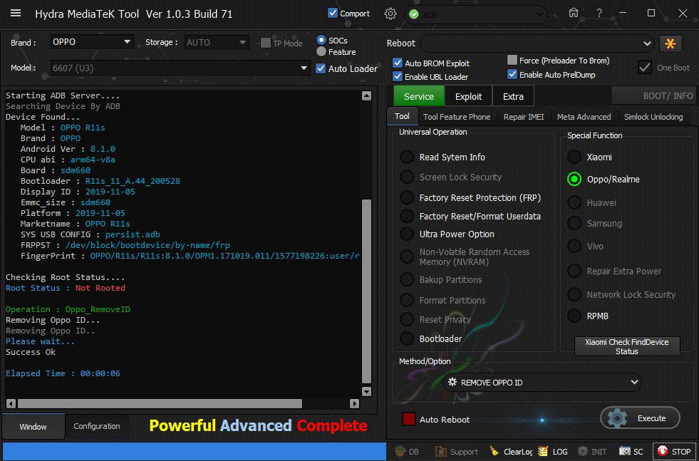

Hydra Oppo R11s Oppo ID successfully removed by Hydra Tool
550
Oppo R11s Oppo ID successfully removed by Hydra Tool​
1. Run Hydra MTK module.
2. Choose Brand and Module
3. Tick "ComPort"
4. Tick "Auto Broom Exploit", "Enable UBL Loader" and "Enable Auto PrelDUMP"
5. Go to "Service" -->"Tool" Tab.
6. Choose "Oppo / Realme"
7. Choose "Remove Oppo/Realme ID" from drop down menu.
8. Tick "Auto Reboot"
9. Click "Execute"
10. connect device to the computer with USB Data cable
11. Wait until the process is completed.
Screen Short:​
