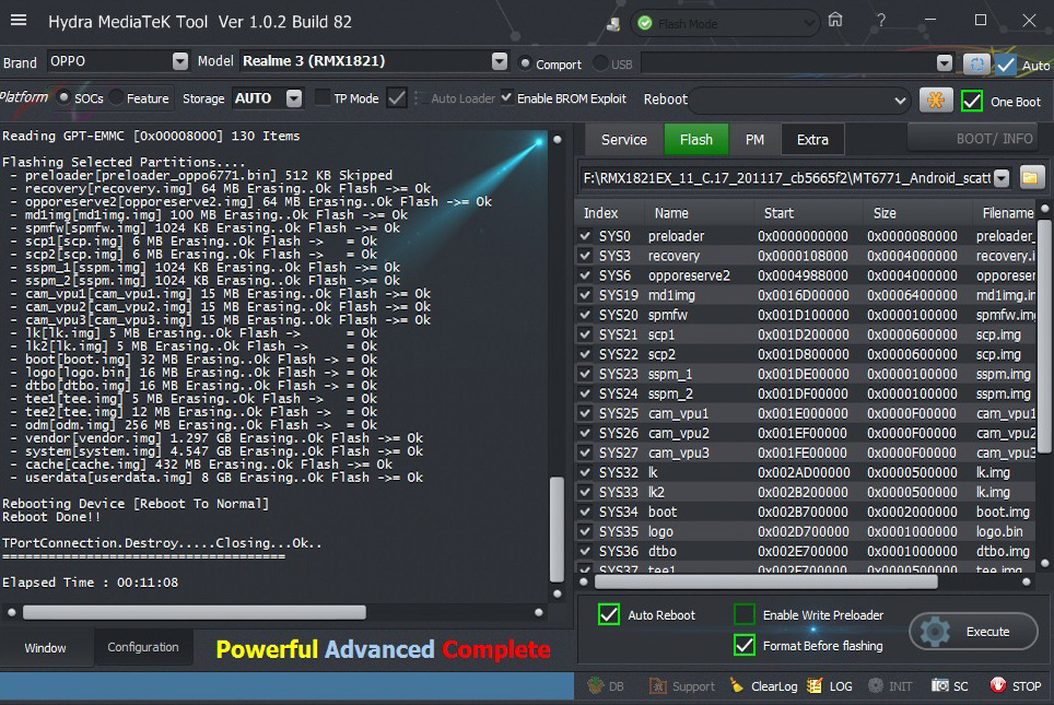

Oppo Realme 3 (RMX1821) Successfully Flashed by Hydra Tool
Brand : OPPO Model : Realme 3 (RMX1821) Connection : Flash Mode
How To Boot : Power off phone
* BROM Mode : Press VOL + or Press VOL -+
Connection
-Please wait...
-Connect Phone...
-Found...[COM3]
TPortConnection.Create...(COM3)..Opening...Ok
Handshaking...Ok
Identifying Hardware ID.....
BROM CPUID : 0788MT6771[6771]
getMTKPayloadExploit : 0788
#Executing Exploit..
#SUCCESS..
Handshaking...Ok
FUSEID : 00000000
SECURE VERSION : 05
BL VERSION : FE
BR Secured : E0
Preparing Download Agent..
DA : [Not Exist]
Trying Default 6771.bin
Ver : MTK_AllInOne_DA_v3.3001.2020-11-03.22:07_536568
Init : Loader [1]
Sending : Accepted
Identifying Protocol...
Protocol : New
Synchronization...SYNC
Mode : brom
Preloader Initialization...
Parsing Realme_3_preloader_oppo6771_18601.bin
Init : Accepted
Execute Secondary Loader
Init : Loader [2]
Executing : SYNC
UNIQUE ID : 86831F42C651C25AF32AB59B19EE27E6
ERAM Size : 0x0000000000039000 -228 KB
eMMC CID : 90014A484347386134A55177811016CB - HCG8a4
DA Speed : high-speed
Reading System Info
Autobackup Partitions
-> Renaming Preloader.... preloader_oppo6771.bin
Creating Scatter file... C:\Hydra Tool\\Backup\Auto\__0788--__260221143631\MT6771_Android_scatter.txt
-frp[0x09E88000]1024 KB ->frp.bin...Ok
-nvdata[0x0BF88000]64 MB ->nvdata.bin...Ok
-persist[0x13800000]48 MB ->persist.bin...Ok
-nvram[0x22D00000]64 MB ->nvram.bin...Ok
Done!!!
- preloader[preloader_oppo6771.bin] 512 KB Skipped
- recovery[recovery.img] 64 MB Erasing..Ok Flash ->= Ok
- opporeserve2[opporeserve2.img] 64 MB Erasing..Ok Flash ->= Ok
- md1img[md1img.img] 100 MB Erasing..Ok Flash ->= Ok
- spmfw[spmfw.img] 1024 KB Erasing..Ok Flash ->= Ok
- scp1[scp.img] 6 MB Erasing..Ok Flash -> = Ok
- scp2[scp.img] 6 MB Erasing..Ok Flash -> = Ok
- sspm_1[sspm.img] 1024 KB Erasing..Ok Flash ->= Ok
- sspm_2[sspm.img] 1024 KB Erasing..Ok Flash ->= Ok
- cam_vpu1[cam_vpu1.img] 15 MB Erasing..Ok Flash ->= Ok
- cam_vpu2[cam_vpu2.img] 15 MB Erasing..Ok Flash ->= Ok
- cam_vpu3[cam_vpu3.img] 15 MB Erasing..Ok Flash ->= Ok
- lk[lk.img] 5 MB Erasing..Ok Flash -> = Ok
- lk2[lk.img] 5 MB Erasing..Ok Flash -> = Ok
- boot[boot.img] 32 MB Erasing..Ok Flash -> = Ok
- logo[logo.bin] 16 MB Erasing..Ok Flash -> = Ok
- dtbo[dtbo.img] 16 MB Erasing..Ok Flash -> = Ok
- tee1[tee.img] 5 MB Erasing..Ok Flash -> = Ok
- tee2[tee.img] 12 MB Erasing..Ok Flash -> = Ok
- odm[odm.img] 256 MB Erasing..Ok Flash -> = Ok
- vendor[vendor.img] 1.297 GB Erasing..Ok Flash ->= Ok
- system[system.img] 4.547 GB Erasing..Ok Flash ->= Ok
- cache[cache.img] 432 MB Erasing..Ok Flash ->= Ok
- userdata[userdata.img] 8 GB Erasing..Ok Flash ->= Ok
Reboot Done!!
Elapsed Time : 00:11:08
