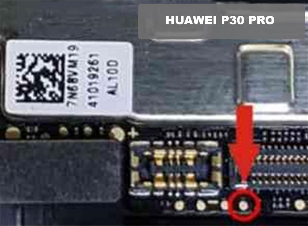

P30 PRO VOG-L29 FRP EFT VIA TEST POINT huawei p30 pro vog-l29 frp remove via testpoint by eft dongle​
shot this point to gnd and plug usb cable without battery
instal usb drivers and show usb com 1.0

Resetting frp.....OK
- Press & Hold power button for 10 seconds to boot device
Operation {Reset FRP [Test Point]} ID: BA87050276519A1B

-Part: [preload]: Address=8447328256 Size=1199570944 LUN=03000000
-Part: [userdata]: Address=9646899200 Size=118287761408 LUN=03000000
Elapsed time 00:26 -- Version 3.9.4
download
