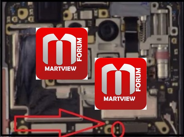

Step:
  • Install QD Loader Driver on PC
  • Remove back Cover of Phone
  • Find out The Pinout as Show In Image
  • Connect Phone to PC with usb Cable
  • take a Coper Wire and Short that Pinout
