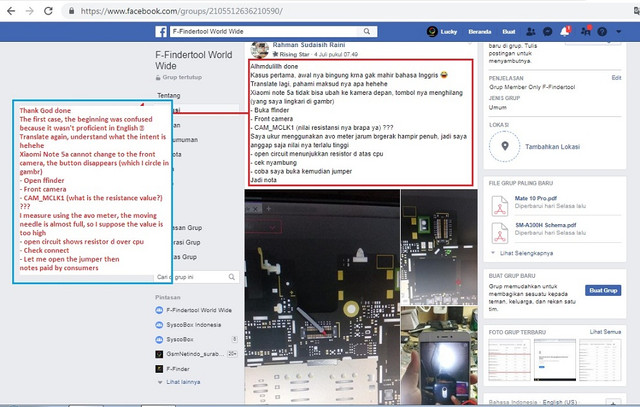

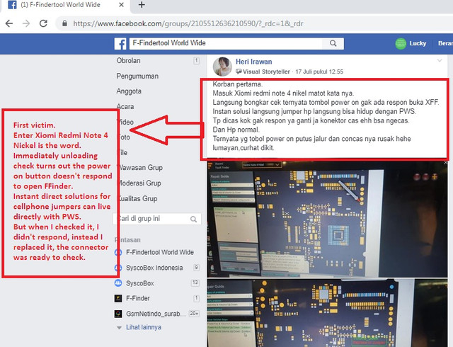

The first case, the beginning was confused because it wasn't proficient in English
Translate again, understand what the intent is hehehe
Xiaomi Note 5a cannot change to the front camera, the button disappears (which I circle in gambr)
  • Open ffinder
  • Front camera
  • CAM_MCLK1 (what is the resistance value?) ???
I measure using the avo meter, the moving needle is almost full, so I suppose the value is too high
  • open circuit shows resistor d over cpu
  • Check connect
  • Let me open the jumper then
notes paid by consumers

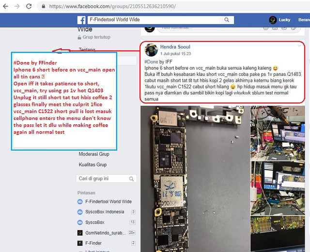

halilintar
Apr 20, 2019
130
298
indonesia

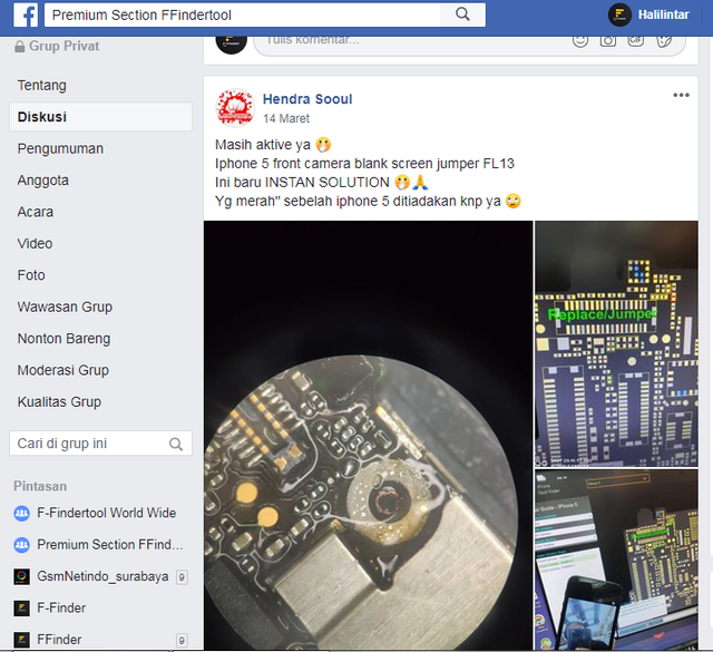

#Done by FFinder Iphone 6 short before on vcc_main open all tin cans Open iff it takes patience to short, vcc_main, try using ps 1v hot Q1403 Unplug it still short tat tut hbis coffee 2 glasses finally meet the culprit 1fice vcc_main C1522 short pull is lost masuk cellphone enters the menu don't know the pass let it dlu while making coffee again all normal test
