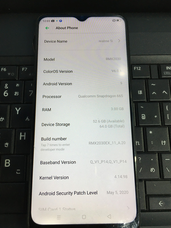

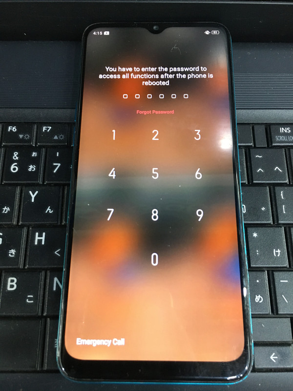

RMX 2030

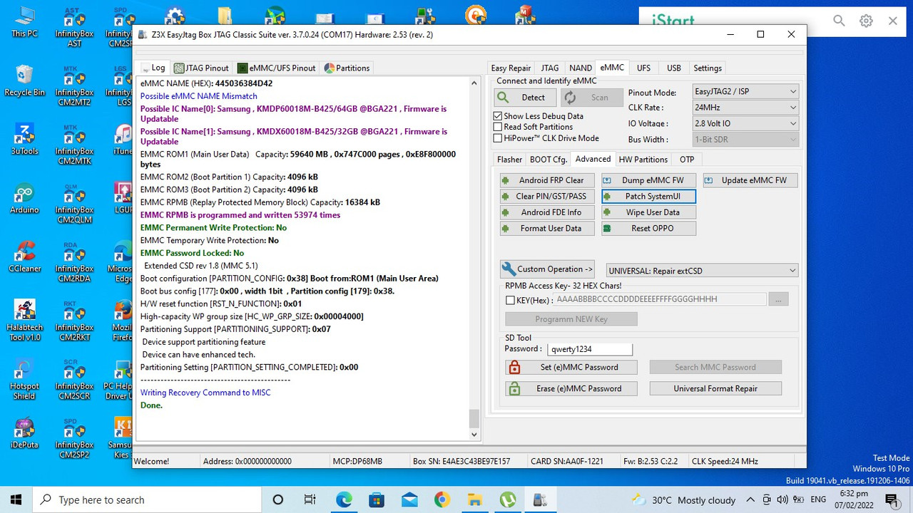

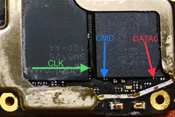

Connect isp CLK, DAT0, CMD and GROUND.
Removed Battery.
Click Detect
Go To Advanced

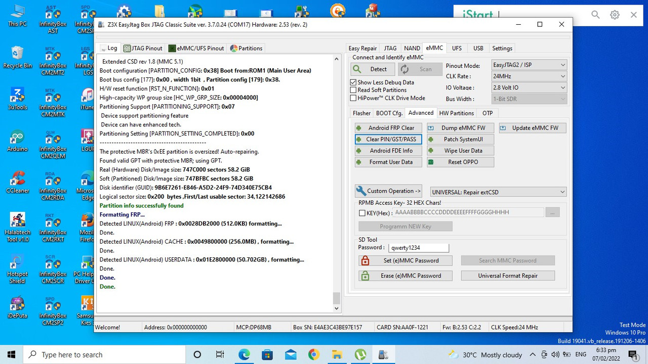

Click Reset Oppo
Click Android FRP Clear

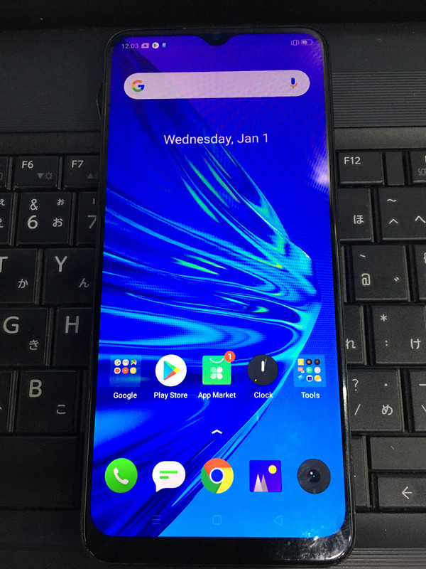

Done.
