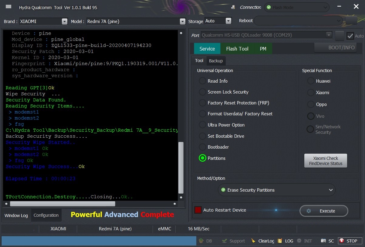

Xiaomi Redmi 7A pine Repair IMEI without waiting unlock bootloader with testpoint
  1. Put your device EDL Mode
  2. by Qualcomm Module Erase Security
  3. Enable diag without root method from reboot box
  4. Write 2nd imei and write eng qcn
PreOperation Configuration
Brand : XIAOMI Model : Redmi 7A (pine) Storage : Auto
Loader: Xiaomi_Redmi_8_Olive.mbn
Port : Auto
Connection : Flash Mode
Searching EDL Port..[COM29]
TPortConnection.Create...(COM29)..Opening...Ok
Getting device info.......
Serial No.: 0x2C20AA47
MSM ID : 0x000BF0E1, SDM439-Qualcomm Snapdragon 439
PBL Ver : 00000001
Firehose Loader[Xiaomi_Redmi.mbn]
Initializing SaharaBoot... Ok
Sending .......................Ok
Connecting to Firehose...
Ping... Ok
Configuration.
Signature Request -> bob[3roRHqBB6fgD8K3p4rZH14Qwqkd]
- Hydra Is Online
Signature @256bytes Authentication.... Accepted......
Identifying Chip....Ok
Chip Configuration :
MemoryName : eMMC
MaxXMLSizeInBytes : 4096
TargetName : 8937
Version : 1
* STORAGE DEVICE INFO *
Memory Type : eMMC
Block Size in Bytes : 512
Page Size : 512
Manufacturer ID : 21
Serial Number : 583130817
Firmware Version : 1
Product Name : QD63MB
Physical Partitions : 3
Total Logical Blocks:
Drive [0] 61071360[29.121 GB]
Drive [1] 8192[4 MB]
Drive [2] 8192[4 MB]
Running : Ok
Reading GPT[3]Ok
Phone Information......
Model : Redmi 7A
Brand : Xiaomi
Android Ver : 9
Miui Ver : V11
Manufacturer : Xiaomi
Device : pine
Mod_device : pine_global
Display ID : ZQL1533-pine-build-20200407194230
Security Patch : 2020-03-01
Kernel ID : 2020-03-01
Fingerprint : Xiaomi/pine/pine:9/PKQ1.190319.001/V11.0.7.0.PCMMIXM:user/release-keys
ro_product_hardware :
sys_hardware_version :
Reading GPT[3]Ok
Wipe Security ...
Security Data Found.
Reading Security Items....
modemst1
modemst2
fsg
C:\Hydra Tool\Backup\Security_Backup\Redmi 7A__9_Security_070520163141.sec
Backup Security Success....
Security Wipe Started..
modemst1 Ok
modemst2 Ok
fsg Ok
Security Wipe Success...Ok
Elapsed Time : 00:00:23

This is what I get when I wipe the security partitions

disable anti-virus and anti-malware
and I'm ready
Hydra Qualcomm Tool Ver 1.0.1 Build 98
Windows 10 (Version 10.0, Build 18362, 64-bit Edition)
Intel(R)Core(TM) i5-2520M CPU @ 2.50GHz
Intel(R) HD Graphics 3000
Ram Installed : 4 GB
Windows Access Right Admin
*** Dongle Info ***
Version : Hydra Tool v 1.2
Serial : 200600003971
Initialize : OKAY
Status : Activated
Life : 0-[0-0-0-0-0]
Port : Auto
Searching EDL Port..[COM10]
TPortConnection.Create...(COM10)..Opening...Ok
Serial No.: 0xF6C48686
PBL Ver : 00000001
Firehose Loader[Xiaomi_Redmi_8_Olive.mbn]
Ping... Ok
Configuration.
Signature Request -> bob[U8hoa0kqvYcCVpK5w5BbGa7uvoH]
- Hydra Is Online
MemoryName : eMMC
TargetName : 8937
Version : 1
Memory Type : eMMC
Page Size : 512
Manufacturer ID : 144
Serial Number : 1011163387
Firmware Version : 165
Product Name : HAG4a2
Drive [0] 30777344[14,676 GB]
Running : Ok
Reading GPT[3], Partitions(60 Items) Ok
Model : Redmi 7A
Brand : Xiaomi
Android Ver : 9
Miui Ver : V11
Device : pine
Wipe Security ...
modemst1
modemst2
fsg
C:\Users\TECNOSHOP_2403\Downloads\HydraTool_Fullpackage_7-04-20_2\Backup\Security_Backup\Redmi 7A__9_Security_072320145842.sec
modemst1 Ok
modemst2 Ok
fsg Ok
Rebooting Phone.... Ok
If not rebooted, Please Power on Manually
Elapsed Time : 00:00:25
