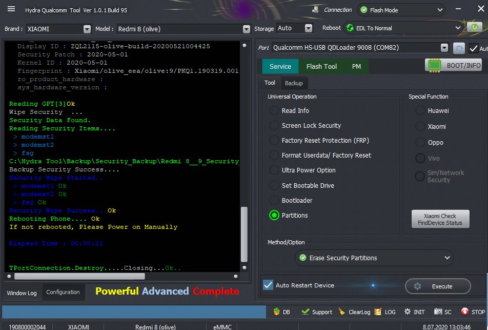

Xiaomi Redmi 8 Olive IMEI Repair Without Root and Unlock Bootloader
Worlds First Direct Repair IMEI Without Auth, Without Credit, Without Unlock Bootloader
1 - Erase Security by EDL Mode
PreOperation Configuration
Brand : XIAOMI Model : Redmi 8 (olive) Storage : Auto
Loader: Xiaomi_Redmi_8_Olive.mbn
Port : Auto
Connection : Flash Mode
Searching EDL Port..[COM82]
TPortConnection.Create...(COM82)..Opening...Ok
Getting device info.......
Serial No.: 0x14406B91
MSM ID : 0x000BF0E1, SDM439-Qualcomm Snapdragon 439
PBL Ver : 00000001
Firehose Loader[Xiaomi_Redmi_8_Olive.mbn]
Initializing SaharaBoot... Ok
Sending .......................Ok
Connecting to Firehose...
Ping... Ok
Configuration.
Signature Request -> bob[xdkl2FTsPUdkvU93
- Hydra Is Online
Signature @256bytes Authentication.... Accepted......
Identifying Chip....Ok
Chip Configuration :
MemoryName : eMMC
MaxXMLSizeInBytes : 4096
TargetName : 8937
Version : 1
* STORAGE DEVICE INFO *
Memory Type : eMMC
Block Size in Bytes : 512
Page Size : 512
Manufacturer ID : 144
Serial Number : 3263672062
Firmware Version : 842018864
Product Name : hC9aP3
Physical Partitions : 3
Total Logical Blocks:
Drive [0] 122142720[58,242 GB]
Drive [1] 8192[4 MB]
Drive [2] 8192[4 MB]
Running : Ok
Reading GPT[3]Ok
Phone Information......
Model : Redmi 8
Brand : Xiaomi
Android Ver : 9
Miui Ver : V11
Manufacturer : Xiaomi
Device : olive
Mod_device : olive_eea_global
Display ID : ZQL2115-olive-build-20200521004425
Security Patch : 2020-05-01
Kernel ID : 2020-05-01
Fingerprint : Xiaomi/olive_eea/olive:9/PKQ1.190319.001/V11.0.7.0.PCNEUXM:user/release-keys
ro_product_hardware :
sys_hardware_version :
Reading GPT[3]Ok
Wipe Security ...
Security Data Found.
Reading Security Items....
modemst1
modemst2
fsg
C:\Hydra Tool\Backup\Security_Backup\Redmi 8__9_Security_070820130236.sec
Backup Security Success....
Security Wipe Started..
modemst1 Ok
modemst2 Ok
fsg Ok
Security Wipe Success...Ok
Rebooting Phone.... Ok
If not rebooted, Please Power on Manually
Elapsed Time : 00:00:21
