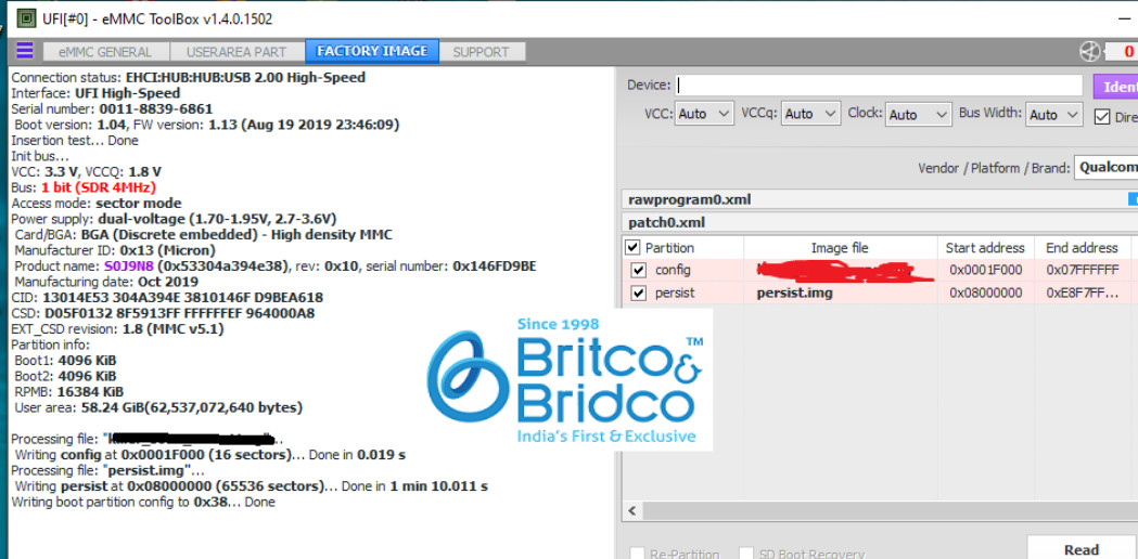

Redmi 8 [Olive] Mi Account & FRP Remove With UFI
Connect ISP
Write Modified File By Britco
After Write File .. Device dead Not On ...
Then I Check ISP Carefully , Found CLK resister Missing
Copy/Paste From Another Device (Redmi 5A) By Lovelince Sir
Finally Device On
