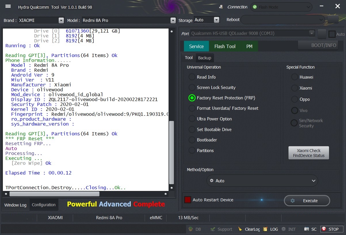

Redmi 8A Pro FRP Remove by Hydra Dongle
Aug 31, 2019
316
372
Ukraine
  1. Go to Hydra Qualcomm Module
  2. Select brand and model, tick factory reset protection frp
  3. Connect device by edl mode
  4. click execute and wait for google account removed
PreOperation Configuration
Brand : XIAOMI Model : Redmi 8A Pro Storage : Auto
Loader: Xiaomi_Redmi_8_Olive.mbn
Port : COM3
Connection : Flash Mode
Port selected..[COM3]
TPortConnection.Create...(COM3)..Opening...Ok
Getting device info.......
Serial No.: 0xA06C83E0
MSM ID : 0x000BF0E1, SDM439-Qualcomm Snapdragon 439
PBL Ver : 00000001
Firehose Loader[Xiaomi_Redmi_8_Olive.mbn]
Initializing SaharaBoot... Ok
Sending .......................Ok
Connecting to Firehose...
Ping... Ok
Configuration.
Signature Request -> bob[VD5czQd9okMhHwpvlF69D926bOR]
- Hydra Is Online
Signature @256bytes Authentication.... Accepted......
Identifying Chip....Ok
Chip Configuration :
MemoryName : eMMC
MaxXMLSizeInBytes : 4096
TargetName : 8937
Version : 1
* STORAGE DEVICE INFO *
Memory Type : eMMC
Block Size in Bytes : 512
Page Size : 512
Manufacturer ID : 21
Serial Number : 3106067390
Firmware Version : 1
Product Name : QD63MB
Physical Partitions : 3
Total Logical Blocks:
Drive [0] 61071360[29,121 GB]
Drive [1] 8192[4 MB]
Drive [2] 8192[4 MB]
Running : Ok
Reading GPT[3], Partitions(64 Items) Ok
Phone Information......
Brand : Redmi
Android Ver : 9
Miui Ver : V11
Manufacturer : Xiaomi
Device : olivewood
Mod_device : olivewood_id_global
Display ID : ZQL2117-olivewood-build-20200228172221
Security Patch : 2020-02-01
Kernel ID : 2020-02-01
Fingerprint : Redmi/olivewood/olivewood:9/PKQ1.190319.001/V11.0.2.0.PCQIDXM:user/release-keys
ro_product_hardware :
sys_hardware_version :
* FRP Reset *
Resetting FRP...
Auto
Processing...
Executing ...
[Zero Wipe] Ok
Elapsed Time : 00.00.12

RED MI 8A PRO FOR MI account remove need credit sir?
Hello, you can do Flash operations for Redmi 8A without credit. But before proceeding have a look at find device status for your device. If its off then you are good to go for permanent. If no then only bypass.
