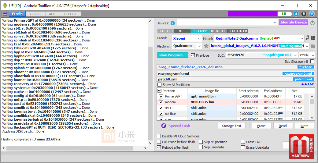

REDMI NOTE-3 HANG ON LOGO SOLVED BY UFI BOX (WITHOUT MANUEL EDL,TEST POINT)
USING MODIFYING FASTBOOT TO EDL FILE
FASTBOOT MODE
FASTBOOT TO EDL DONE

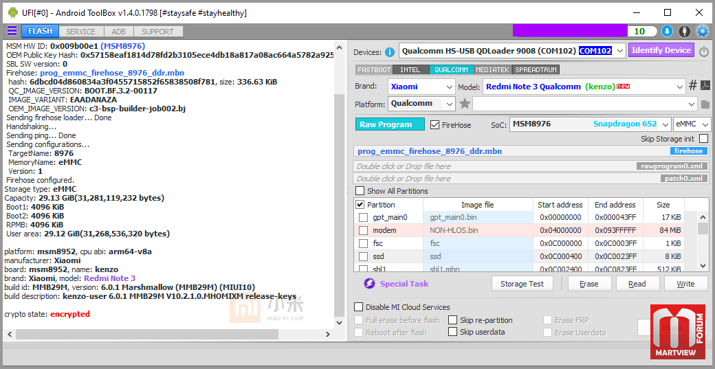

THEN READ INFO
FLASH

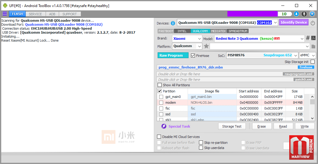

SAME PROCEDURE TO GET EDL MODE AGAIN FOR FRP-MI ACC UNLOCK
FRP RESET
RESET MI ACCOUNT

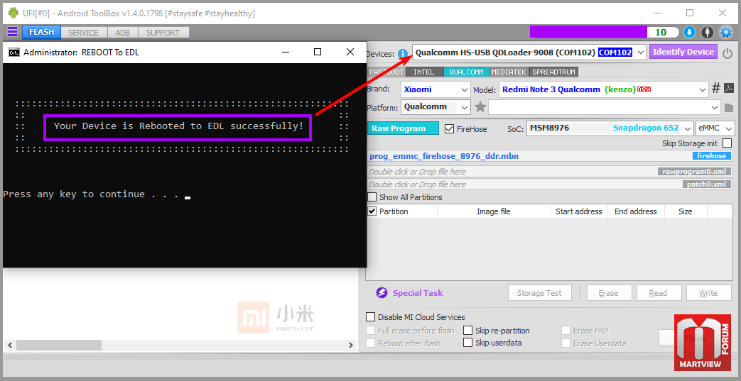

FASTBOOT MODE
THEN READ INFO
FLASH

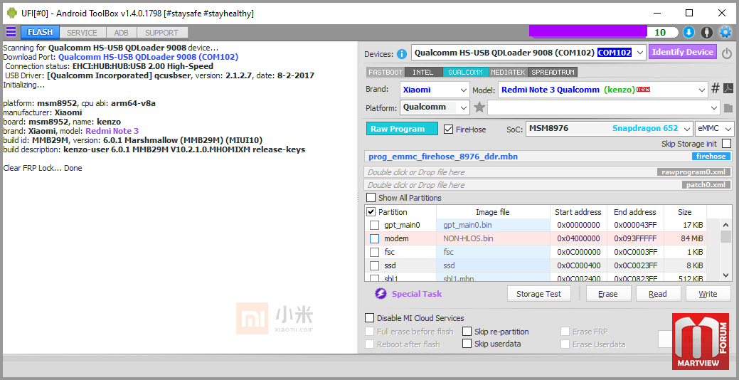

FRP RESET
RESET MI ACCOUNT

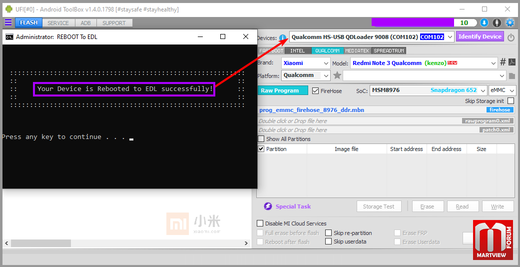

DETAILS PROCEDURE HERE :

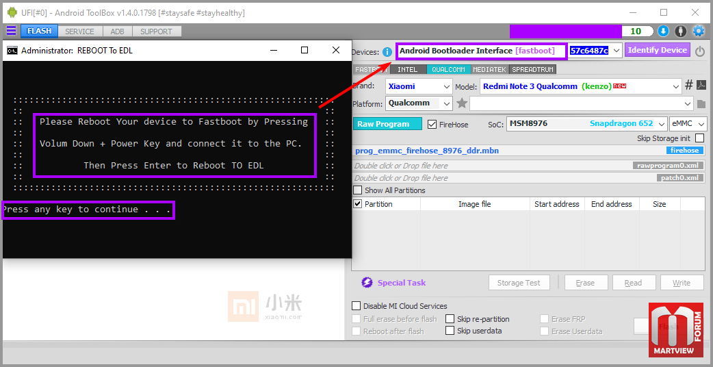

WHEN CREATE FASTBOOT TO EDL MUST REMOVE BATTERY.
THEN PRESS VOL DOWN & POWER BUTTON THEN INSERT USB
TO GET FASTBOOT MODE.
THEN OPEN "Fastboot_To_EDL" FOLDER
IN FOLDER HIT Reboot.bat TO GET EDL MODE.
THEN SHOW EDL MODE (9008).
THEN CREATE YOUR JOB.
THAT'S ALL ENJOY.
