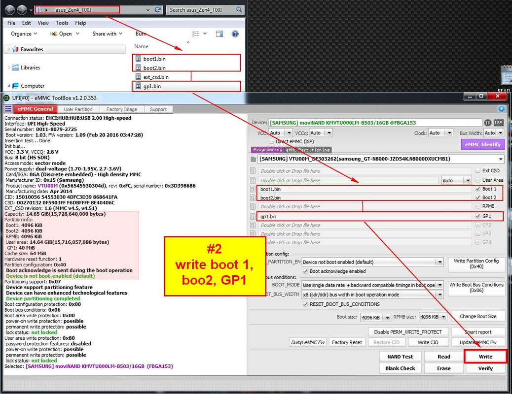

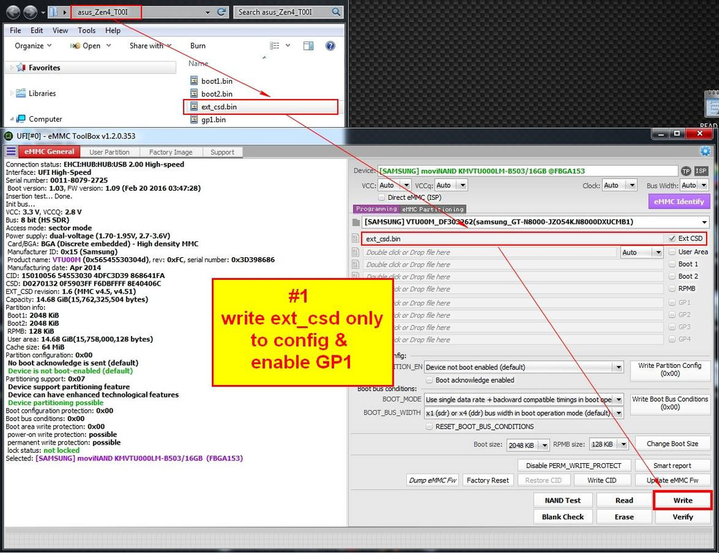

Commonly we using Samsung KMVTU000LM-B503, but most emmc with bga 153 is supported.
Download Dump File in support page.

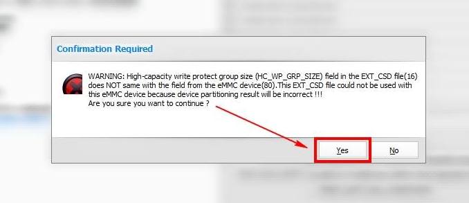

Write only ext_csd to enable GP1 partition.
And just click Yes in Confirmation Dialog
Now write only boot1, boot2, and GP1 image, without user area.

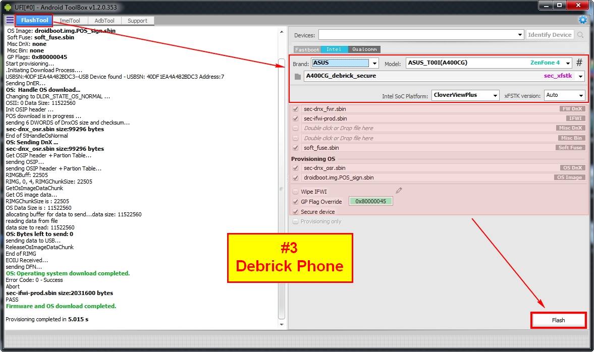

Now Debrick devices using Ufi Android Tools as pic below

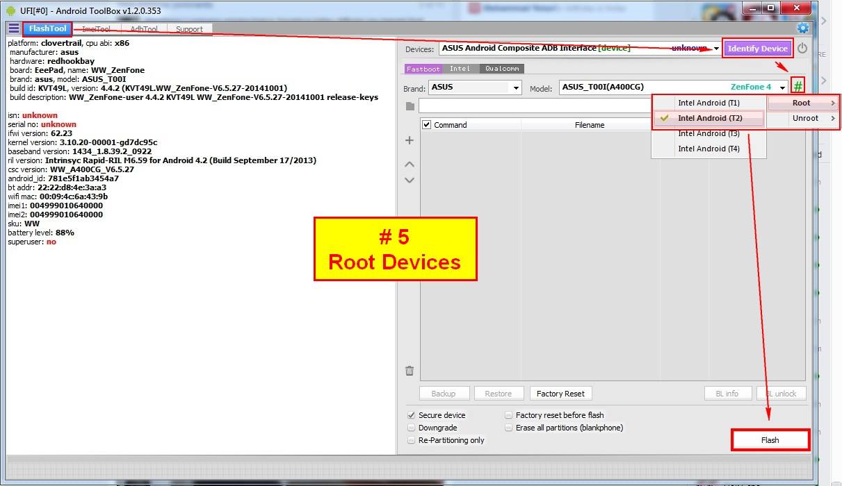

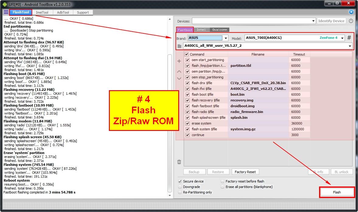

After debrick success, your devices will restart and go into Fastboot Mode and Ready to Flash
Flashing complete, now wait until Devices fully working, enable USB Debugging its time to Root using Ufi Android ToolBox

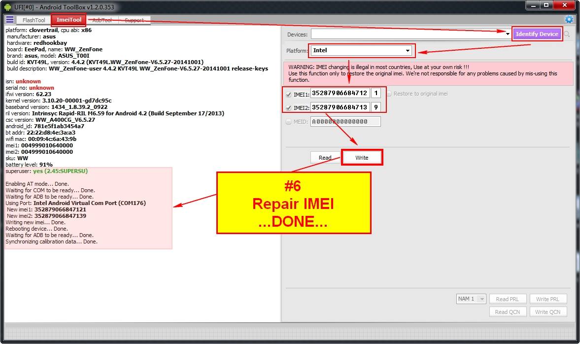

After Root complete, we are ready to repair imei.
Go in to tab Service, Identify devices first to auto set brand and model, and you are ready to repair imei

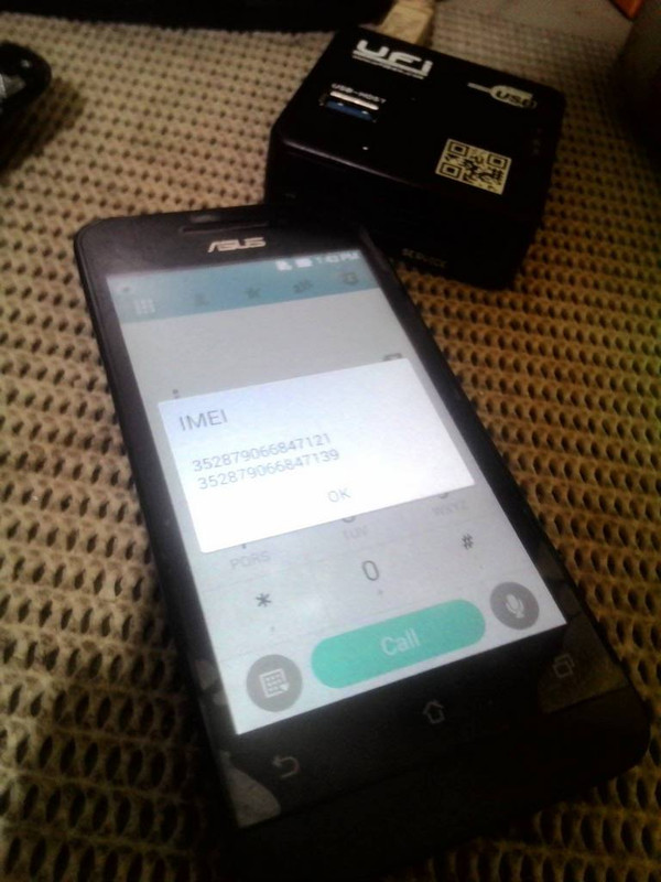

Devices will restart several times, now lets check the Devices
