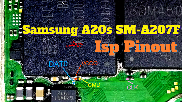

Samsung A20s Isp Pinout SM-A207F

thanks frp Done via ufi
Connection status: EHCI:HUB:HUB[#2]:USB 2.00 High-Speed
Interface: UFI High-Speed
Serial number:
Boot version: 1.05, FW version: 1.14 (Aug 25 2021 04:56:05)
Insertion test... CLK not properly connected
Init bus...
VCC: 3.3 V, VCCQ: 1.8 V
Bus: 1 bit (SDR 24MHz)
Access mode: sector mode
Product name: GD6BMB (0x474436424d42), rev: 0x01, serial number: 0xC97E6AC9
Manufacturing date: Nov 2019
CID: 15010047 4436424D 4201C97E 6AC9B658
CSD: D0270132 0F5903FF F6DBFFEF 8E40400C
Firmware version: 0x01
EXT_CSD revision: 1.8 (MMC v5.1)
Partition info:
Boot1: 4 MiB
Boot2: 4 MiB
RPMB: 4 MiB
User area: 29.12 GiB(31,268,536,320 bytes)
Erasing xxx at 0x31400000-0x3147FFFF size: 512 KiB... Done in 0.008 s
