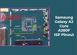

Samsung Galaxy A2 Core A260F ISP Pinout Image​

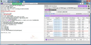

Samsung Galaxy A2 Core A260F Pattern FRP Using UFI Box​
  • Remove the back panel of the device and connect the wire to the ISP Pinout.
  • Next, connect the correct ISP Pinout to the UFi Box
  • Check “Direct eMMC (ISP)”
  • Then Click on “Identify eMMc.
  • Connect your Samsung Galaxy A2 Core A260F to the PC via a USB cable.
  • Head over to the PC and open Device Manager.
  • If your device is located there, run the UFi Box.
  • Go to USERAREAPART
  • Now Click on Special Task ► [Oppo] MasterClear ► Wipe Data Only
  • Now Click on Special Task ► Clear FRP Lock
  • Done.
