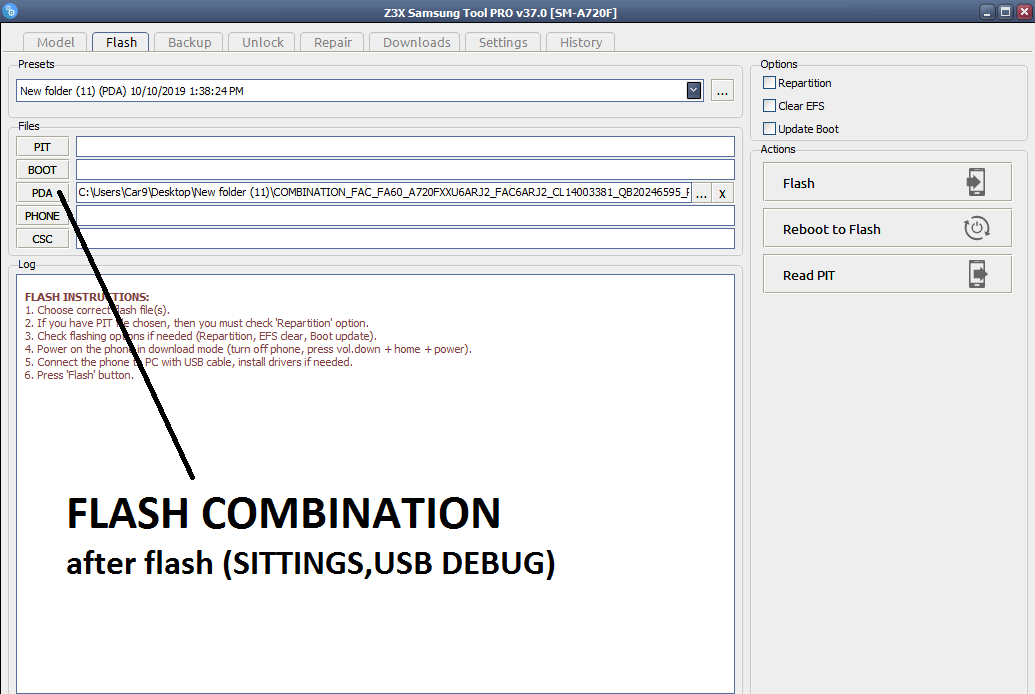

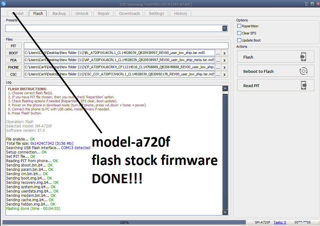

2. a720f FLASH COMBINATION

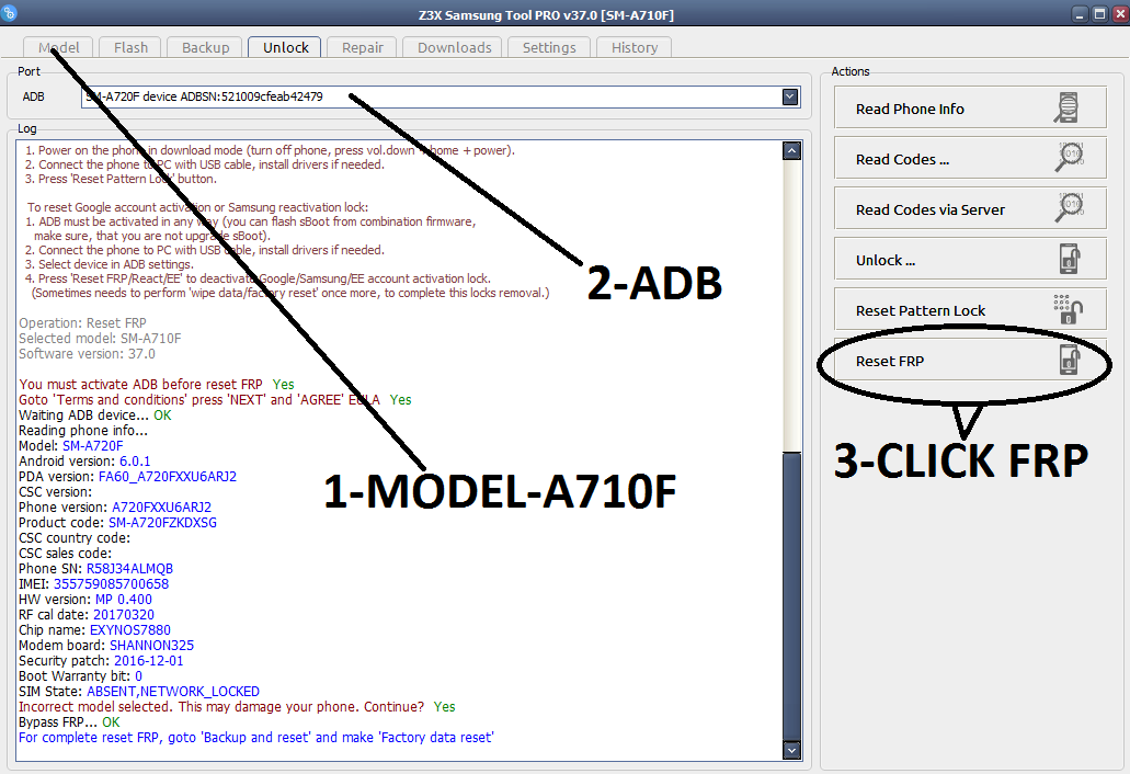

3.after flash(Sittings,USB dibug,)go to z3x model CLICK a710f (UNLOCK,ADB) RESET FRP

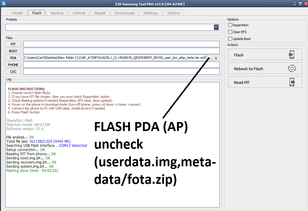

4. a720f Flash PDA (AP) uncheck (userdata.img.lz4 & meta-data/fota.zip) Done

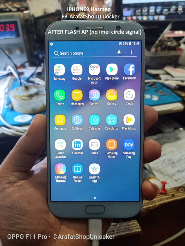

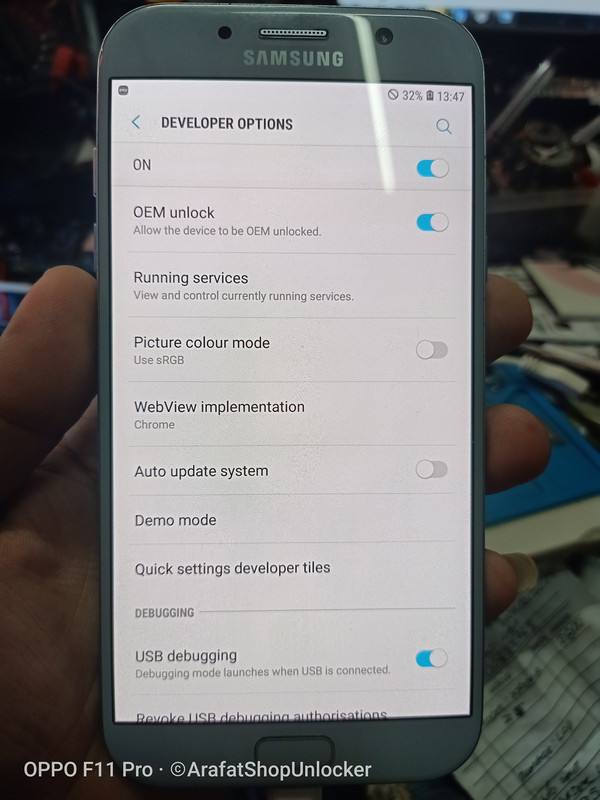

5.after flash pda go to sittings enable OEM & USB DEBUG

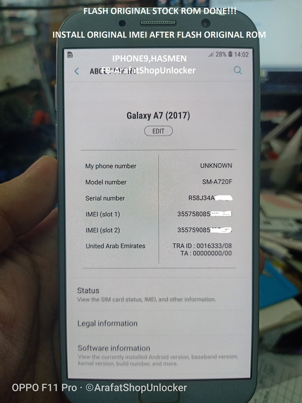

6.Flash Original Stock firmware
7.DONE!!
