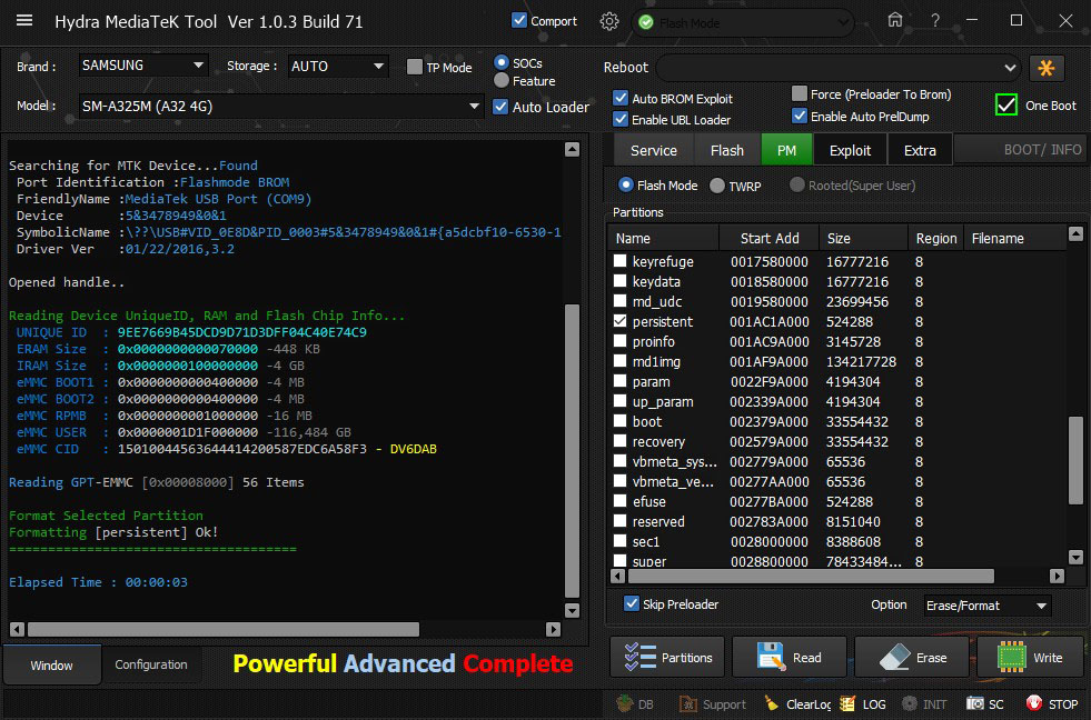

Hydra Samsung SM-A013F (A01 Core) formatted selected partition to remove frp done by Hydra
550
1. Run MTK tool of Hydra Dongle.
2. Choose Correct Module and Brand.
3. Choose "Auto Broom Exploit", "Enable UBL Loader"
Note: Please check screen short properly to check and uncheck them.
4. Click on "Boot / Info" and wait it reads all.
5. Go to "PM" Tab
6. Skip "preloader"
7. Click on "Partition" button.
8. Now connect device to computer with Data Cable.
9. Wait it shows the different partition.
10. Choose "Presistent"
11. Click on "Erase"
12. Wait until the process is completed
Samsung-SM-A325-M-A32-4-G-formatting-selected-partiton-successfully-done-by-Hydra-Tool.jpg
