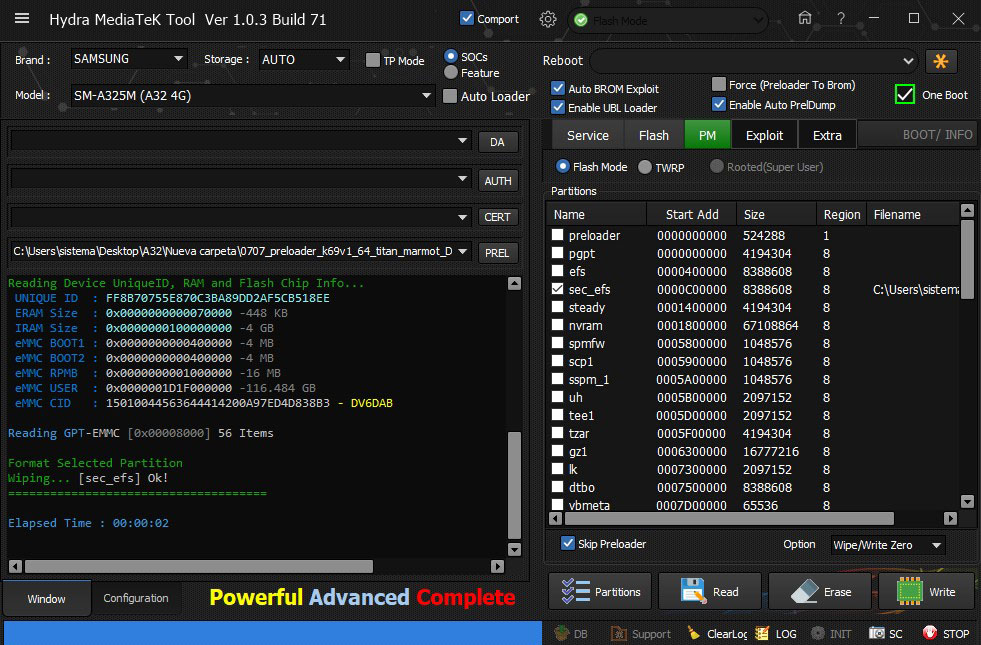

Samsung SM-A32M (A32 4G) wiping selected partition successfully done by Hydra
1. Run MTK Tool and choose "Sosc"
2. Choose Brand and Module.
Note: If auto boot not support, then you have choose manual boot as shown below. For this, untick "AUTO BOOT". If you do not HAVE boot file, even you can make boot file from hyda EXPLOIT tab.
3. Go to "Service"--> "Tool"
4. Tick "ComPort"
5. Tick "Auto Broom Exploit" and "Enable UBL Loader" and "
Enable auto preEump"
6. Choose "PM" Tab
7. Choose "Flash Mode"
8. Click on "Partition"
9. Connect device to computer using USB Data Cable.
10. Wait until the operation shows the all partition of you cellphone.
11. Choose "Sec_efs" or any partition you choose
12. Click "Erase" to remove it. If you want to read it, then, click "Read" and if you want to write it click on "Write"
13. Wait until the operation is completed.
