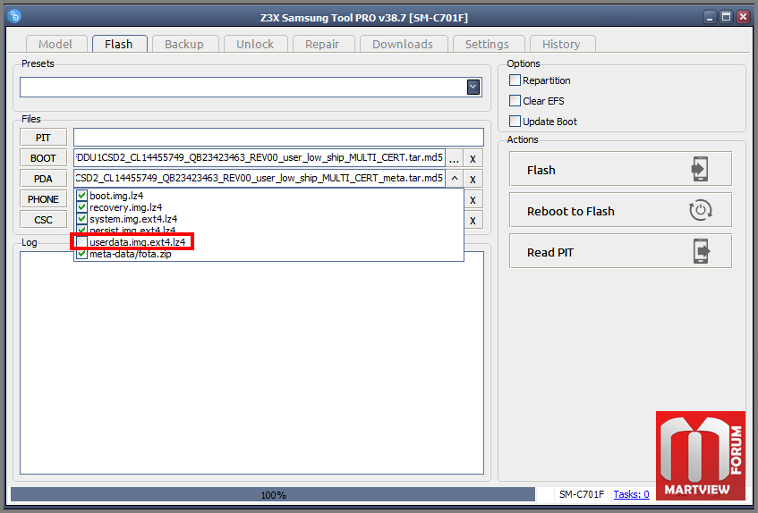

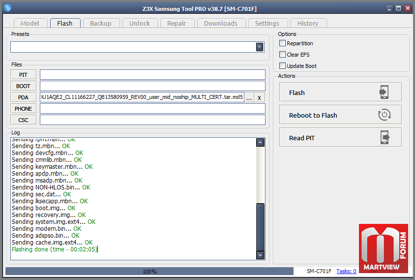

FRP Reset Process :

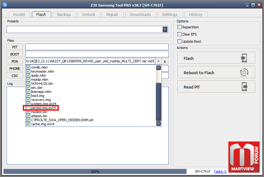

1.First Flash Combination File Untick Persist.
2.After Flash Combination Goto Settings Enable USB Debg. And Oem Unlock.

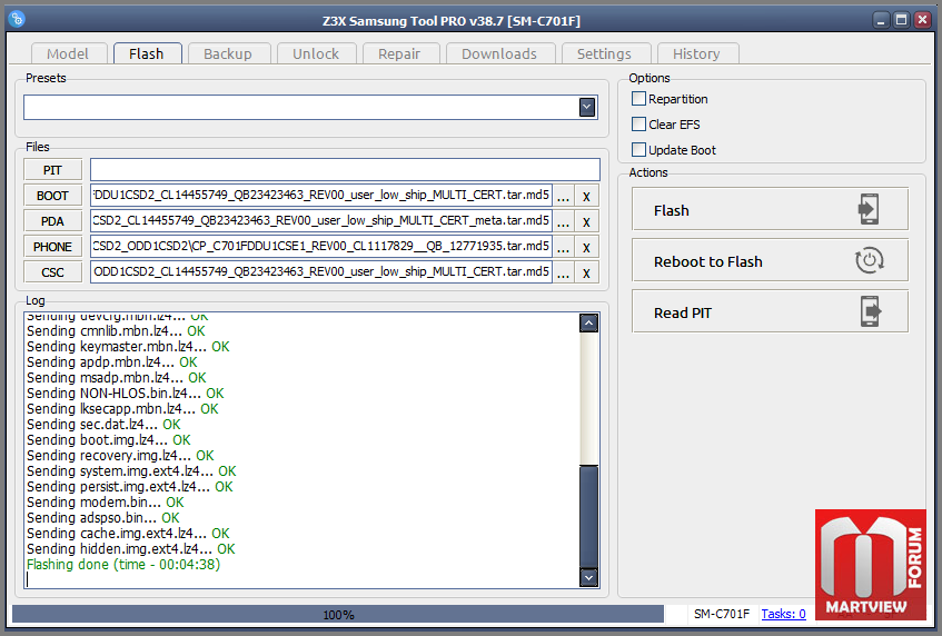

3.Now Full Flash With Latest Firmware Without Userdata.

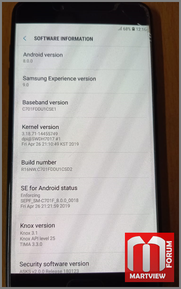

Frp Reset Done 100%..........
