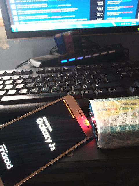

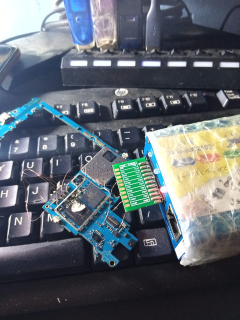

Samsung SM-J200H Dead Boot Repair With Medusa Pro
Unlockinfo
Feb 6, 2020
394
437
unlockinfo

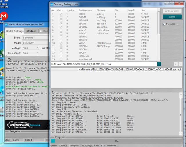

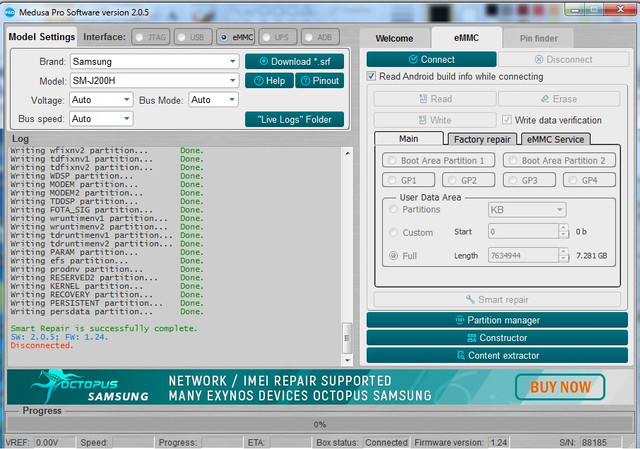

After Repair Boot Flash Log :
Welcome to Medusa Pro Software version 2.0.5.
Started.
Reader #0: Generic EMV Smartcard Reader 0
Reader #1: Generic EMV Smartcard Reader 1
Reader #2: Generic EMV Smartcard Reader 2
Please disconnect battery and USB cable.
Model Settings:
Interface : eMMC
Brand : Samsung
Model : SM-J200H
SRF : C:/Program Files/Medusa Pro Software/firmwareFolder/SAMSUNG_SM-J200H_EMMC.srf
Voltage : 1.8V
Bus Mode : 1 bit
Bus speed : Auto
Connecting...
Device : Hynix eMMC H8G4t!
Page size : 512 B
Block size : 512 B
Block count : 15269888
Size : 7.28 GB (7456.00 MB)
CID Info
CID : 90014A483847347421017EB0447EA2FB
Manufacturer ID : 0X90
Device/BGA : BGA (Discrete embedded)
OEM/Application ID : 0X4A
Product name : H8G4t!
Product revision : 0.1
Product serial number : (hex) 7EB0447E
Manufacturing date : 10/2015
CSD Info
CSD : D07F01320F5903FFFFFFFFEF8A400013
CSD structure : CSD version No. 1.2
SPEC version : 4.1, 4.2, 4.3, 4.4, 4.41, 4.5,
4.51, 5.0, 5.01, 5.1
Data read access time1: 80 ms
TRAN speed : 26 MHz
READ block length : 512 Bytes
WP group enable : YES
PERM_WRITE_PROTECT : NO
TMP_WRITE_PROTECT : NO
EXTCSD Info
Revision 1.7 (for MMC v5.0, v5.01)
Erase block size : 512 Kbytes
Boot1 size : 4096 Kbytes
Boot2 size : 4096 Kbytes
RPMB size : 4096 Kbytes
Partition config : (0x08) 00001000
Boot partition enable : Boot partition 1
(Bus width = 1Bit)
Boot ACK : No boot acknowledge sent (default)
Boot bus conditions : (0x00) 00000000
Boot bus width : x1 (sdr) or x4 (ddr) bus width in boot operation mode (default)
Reset boot bus conditions : Reset bus width to x1, single data rate and backward compatible timings after boot operation (default)
Boot mode : Use single data rate + backward compatible timings in boot operation (default)
RST_n function : (0x00) RST_n signal is temporary disabled (default)
Partitioning support : Device supports partitioning features
Enhanced attribute : Device can have enhanced technological features in partitions and user data area.
Max enhanced data size: 3817472 Kbytes
Partitions attribute : 0x0
Part setting completed: 0x1
GP partition 1 size : 0 b
GP partition 2 size : 0 b
GP partition 3 size : 0 b
GP partition 4 size : 0 b
Enhanced area size : (0x0) 0 b
Enhanced area start : (0x0) 0 b
---------------------------------------------------------------Searching Android build info...
Backup EXT_CSD saved to file C:/Program Files/Medusa Pro Software/EXT_CSD Backups/H8G4t!_08_04_2020_20_50_07.bin.
Connect successful.
SW: 2.0.5; FW: 1.24.
P00: GPT (00000000, 00002000) 4 MB
P01: sboot (00002000, 00001000) 2048 KB
P02: sboot2 (00003000, 00001000) 2048 KB
P03: wfixnv1 (00004000, 00000800) 1024 KB
P04: wfixnv2 (00004800, 00000800) 1024 KB
P05: tdfixnv1 (00005000, 00000800) 1024 KB
P06: tdfixnv2 (00005800, 00000800) 1024 KB
P07: wdsp (00006000, 00002000) 4 MB
P08: modem (00008000, 00004000) 8 MB
P09: modem2 (0000C000, 00004000) 8 MB
P10: tddsp (00010000, 00002000) 4 MB
P11: fota_sig (00012000, 00000800) 1024 KB
P12: wruntimenv1 (00012800, 00000800) 1024 KB
P13: wruntimenv2 (00013000, 00000800) 1024 KB
P14: tdruntimenv1 (00013800, 00000800) 1024 KB
P15: tdruntimenv2 (00014000, 00000800) 1024 KB
P16: param (00014800, 00001000) 2048 KB
P17: efs (00015800, 0000A000) 20 MB
P18: prodnv (0001F800, 00002800) 5 MB
P19: reserved2 (00022000, 00001000) 2048 KB
P20: kernel (00023000, 00008000) 16 MB
P21: recovery (0002B000, 00008000) 16 MB
P22: persistent (00033000, 00000800) 1024 KB
P23: persdata (00033800, 00004800) 9 MB
P24: cache (00038000, 00064000) 200 MB
P25: system (0009C000, 002EE000) 1500 MB
P26: hidden (0038A000, 0000F000) 30 MB
P27: userdata (00399000, 00AF5000) 5.479 GB
Backuping efs partition...
Opening C:/Program Files/Medusa Pro Software/Backups/H8G4t!_efs_0x15800_0xa000_08_04_2020_20_50_07.bin file...
Reading. Please wait... Done.
Elapsed time 00:00:09
Selected pit file: H:/Firmware/SM-J200h/5.1/SM-J200H_DS_4-10-2016_20-1-19.pit
Open file "H:/Firmware/SM-J200h/5.1/SM-J200H_1_20180911191101_0o21da4wry/J200HXXS0ARI1_J200HOJV0ARE1_J200HXXU0ARE1_HOME.tar.md5".
Writing MBR...Done.
Writing primary GPT...Done.
Writing secondary GPT...Done.
Writing PIT
Write data verification is enabled.
Writing. Please wait...
Writing partition wfixnv2... from 4800 to 164 Done.
Writing partition WDSP... from 6000 to 1000 Done.
Writing partition MODEM... from 8000 to 4000 Done.
Writing partition KERNEL... from 23000 to 6943 Done.
Writing partition RECOVERY... from 2B000 to 6EDF Done.
Writing partition CACHE... from 38000 to 14341 Done.
Writing partition SYSTEM... from 9C000 to 2A59E7 Done.
Writing partition HIDDEN... from 38A000 to D06A Done.
Writing is finished.
