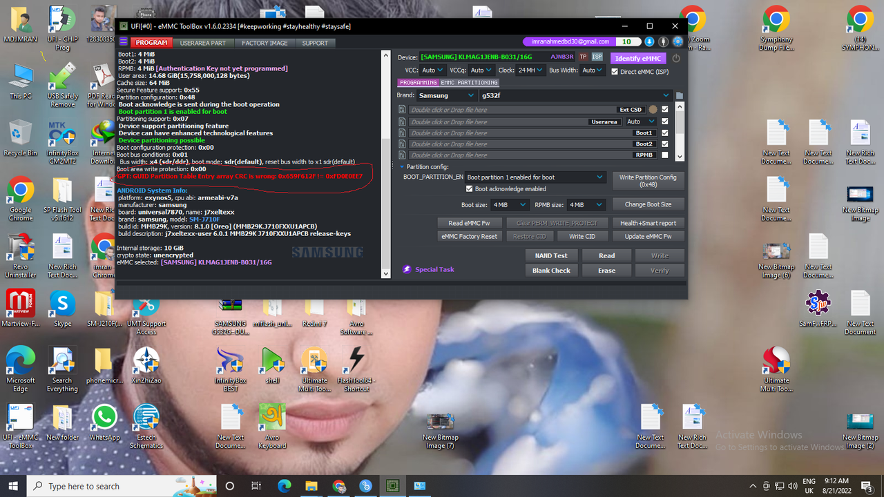

Connection status: XHCI:HUB3[#4]:USB 2.00 High-Speed
Interface: UFI High-Speed
Serial number: 0011-8841-5911
Boot version: 1.05, FW version: 1.13 (Aug 19 2019 23:46:09)
Insertion test... Done
VCC, VCCQ not properly connected
Init bus...
VCC: 3.3 V, VCCQ: 1.8 V
Bus: 1 bit (SDR 24MHz)
Access mode: sector mode
Product name: AJNB3R (0x414a4e423352), rev: 0x01, serial number: 0x0C7C4377
Manufacturing date: Aug 2016
CID: 15010041 4A4E4233 52010C7C 4377833C
CSD: D0270132 0F5903FF F6DBFFEF 8E40400C
Firmware version: 0x01
EXT_CSD revision: 1.7 (MMC v5.0, v5.01)
Partition info:
Boot1: 4 MiB
Boot2: 4 MiB
RPMB: 4 MiB [Authentication Key not yet programmed]
User area: 14.68 GiB(15,758,000,128 bytes)
Cache size: 64 MiB
Secure Feature support: 0x55
Partition configuration: 0x48
Boot acknowledge is sent during the boot operation
Boot partition 1 is enabled for boot
Partitioning support: 0x07
Device support partitioning feature
Device can have enhanced technological features
Device partitioning possible
Boot configuration protection: 0x00
Boot bus conditions: 0x01
Bus width: x4 (sdr/ddr), boot mode: sdr(default), reset bus width to x1 sdr(default)
Boot area write protection: 0x00
GPT: GUID Partition Table Entry array CRC is wrong: 0x659F612F != 0xFD0E0EE7
ANDROID System Info:
platform: exynos5, cpu abi: armeabi-v7a
manufacturer: samsung
board: universal7870, name: j7xeltexx
brand: samsung, model: SM-J710F
build id: MMB29K, version: 8.1.0 [Oreo] (MMB29K.J710FXXU1APCB)
build description: j7xeltexx-user 6.0.1 MMB29K J710FXXU1APCB release-keys
Internal storage: 10 GiB
crypto state: unencrypted
eMMC selected: [SAMSUNG] KLMAG1JENB-B031/16G
