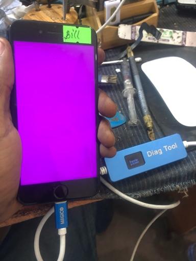

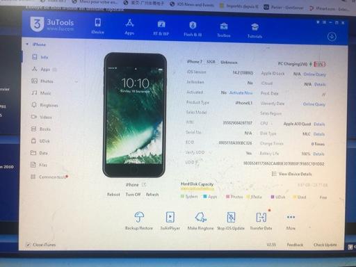

History: iPhone 7 ERROR 4013
No way to read hard disk information

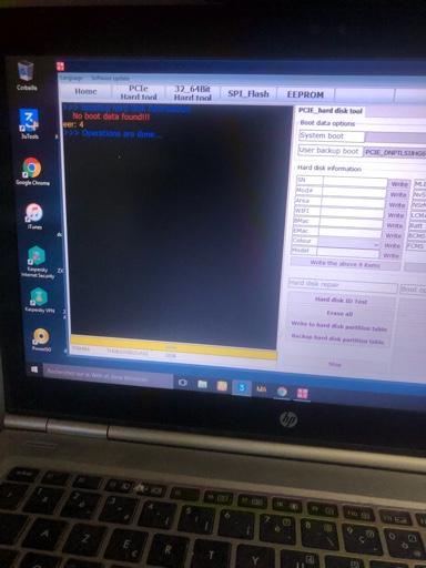

>>> Initializing PCIe interface...
Hard disk has been detected...
>>> Initializing the hard disk...
Hard disk information not detected... bad hard disk contact or damaged partition table!!!...
This hard drive will report error: 9 or 6 or 14...
Please try [Erase All]!!! If you still can't detect the hard disk information!!! Write [write to the hard disk partition table]
>>> Operations are done...
Solution:
1-Erase All (Retain partition table and boot information)
2-Hard disk initialization & Read all the l'information
3-Back up the boot data (backup boot)
4-Erase All (Erase all data,delete partition table and boot information)
5- Hard disk initialization

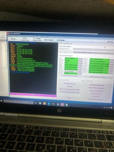

You would get this message:
>>> Tip: This hard drive can be brushed normally...
Capacity: 32GB
Partition Table:
nvme00
>>> Reading hard disk information
No boot data found!!!
eer: 4

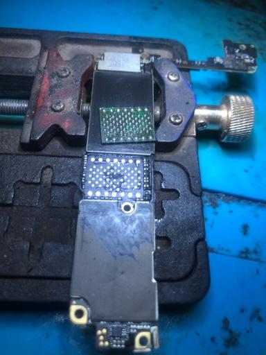

6-Reball Nand then restored that via 3utools or iTunes

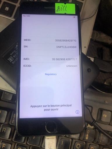

7-Enter purple mode to write the backup
8-Then restored it
9- okay
