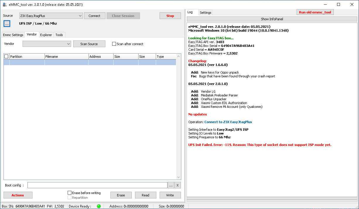

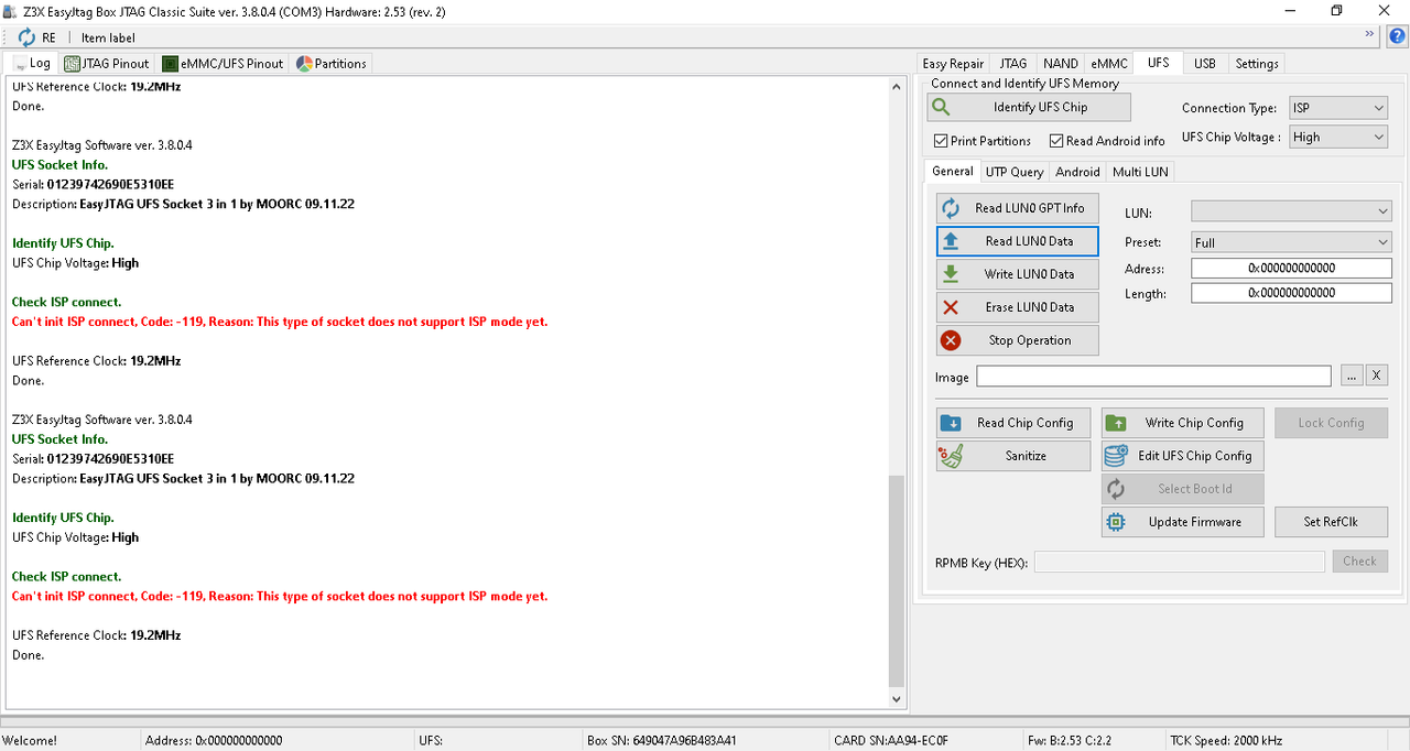

This type of seocket does not support isp mode yet

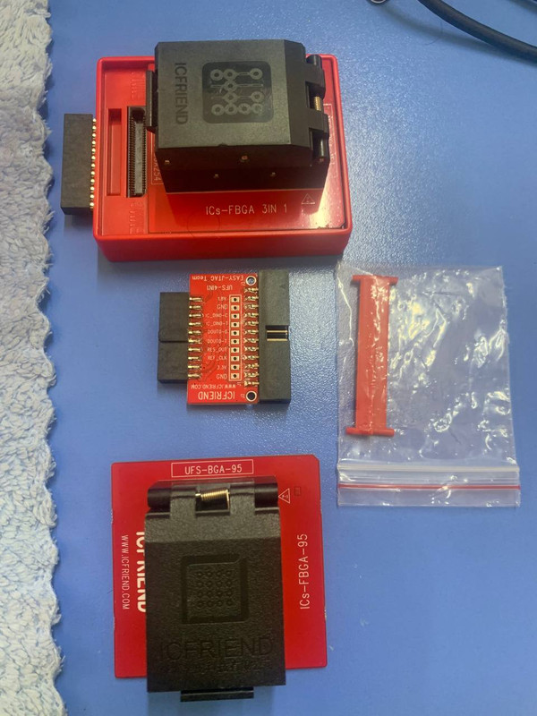

Thanks for answer. Cancyou explain how you solved? Also how ufs socket? Is it good? I mean good than original easjtag sockets? What is your opinion

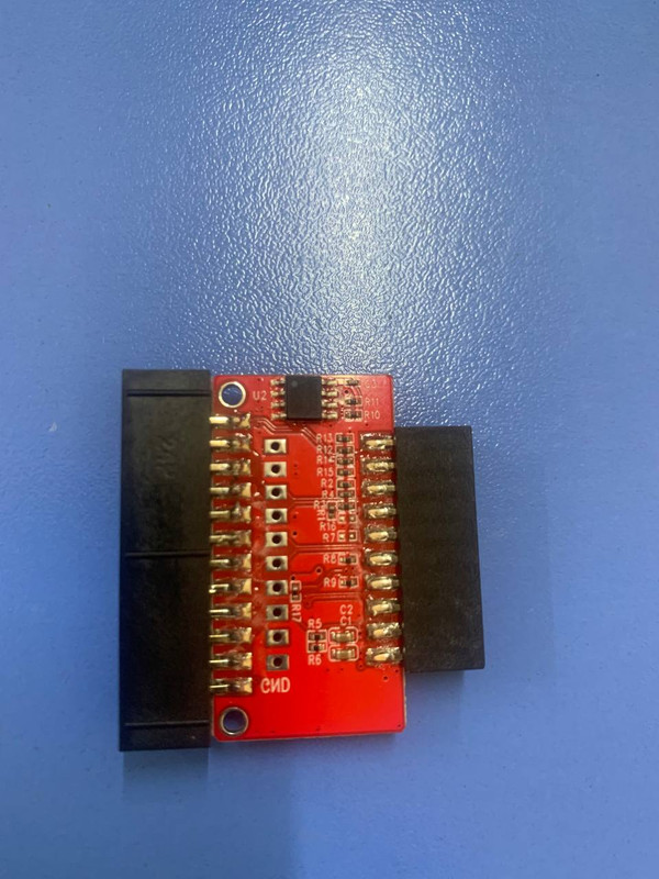

Both sockets are good.Just solder well the pins and connect gnd very important.My suggestion is buy z3x bga-254 socket if you work with isp.
