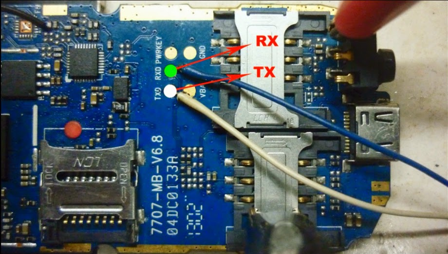

open phone find rx tx pinout on pcb solder it
(its feture phone pic andriod device also contain rxtx )

Note : uart flashing too slow so better flash only boot.img and preloader after u can flash with usb
