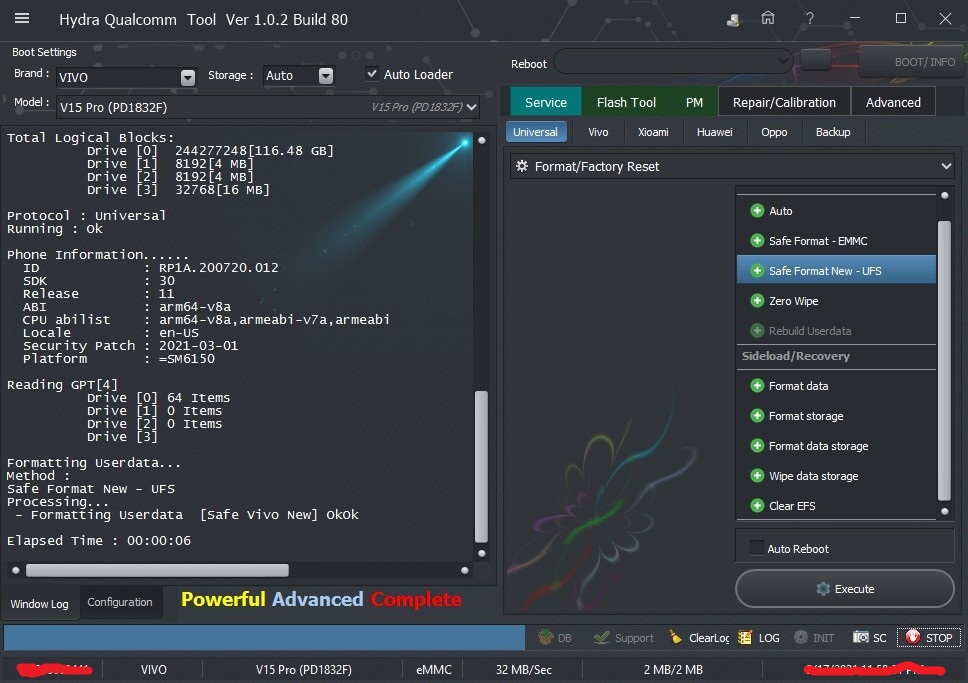

Vivo V15 Pro (PD1832F) safe format UFS successfully done by ELD mode by Hydra
1. Choose Brand and Module.
2. Go "Service"-->"Universal"
3. Choose "Format Factory Reset" from drop down menu.
4. Choose "Safe format NEW - UFS"
5. Click "Execute"
6. Connect cellphone to computer with the help of USB Data Cable.
7. Wait until the operation is completed.
Screen Shorts
Logs
PreOperation Configuration
Brand : VIVO Model : V15 Pro (PD1832F) Storage : Auto
Loader: Vivo_V17_Pro_SDM675.elf
Port : Auto
Connection :
FriendlyName :Qualcomm HS-USB QDLoader 9008 (COM84)
SymbolicName :\??\USB#VID_05C6&PID_9008#5&21a532bb&0&2#{a5dcbf10-6530-11d2-901f-00c04fb951ed}
Driver Ver :03/10/2015,2.01.01.00
Getting device info..Ok
Device MODE : Firehose
Connecting to Firehose...
Ping..................... Ok
Configuration........
Identifying Chip....
Ok
Chip Configuration :
MemoryName : eMMC
MaxXMLSizeInBytes : 4096
TargetName :
Version : 1
DateTime : Jul 2 2020 - 22:00:29
*** STORAGE DEVICE INFO ***
Memory Type : eMMC
Block Size in Bytes : 512
Page Size : 512
Manufacturer ID : 21
Serial Number : 2359807229
Firmware Version : 2
Product Name : 3V6CMB
Physical Partitions : 4
Total Logical Blocks:
Drive [0] 244277248[116.48 GB]
Drive [1] 8192[4 MB]
Drive [2] 8192[4 MB]
Drive [3] 32768[16 MB]
Protocol : Universal
Running : Ok
Phone Information......
SDK : 30
Release : 11
ABI : arm64-v8a
Locale : en-US
Security Patch : 2021-03-01
Platform : =SM6150
Reading GPT[4]
Drive [0] 64 Items
Drive [1] 0 Items
Drive [2] 0 Items
Drive [3]
Formatting Userdata...
Method :
Safe Format New - UFS
Processing...
- Formatting Userdata [Safe Vivo New] OkOk
Elapsed Time : 00:00:06
