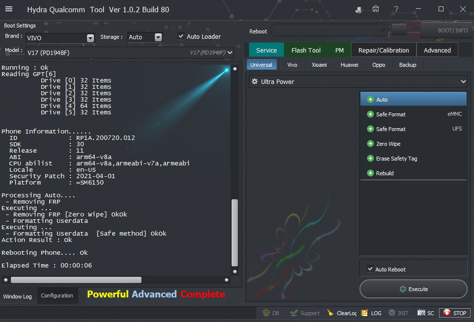

Hydra Vivo V17 (PD1945F) safe format user data and zero wipe successfully done by Hydra Tool
550
1. Run Hydra Qualcomm Tool.
2. Choose Brand and Module.
3. Go "Service"-->"Universal"
4. Choose "Ultra PowerP" from drop down menu.
5. Choose "Auto"
6. Click "Execute"
7. Connect cellphone to computer with the help of USB Data Cable.
8. Wait until the operation is completed.

PreOperation Configuration
Brand : VIVO Model : V17 (PD1948F) Storage : Auto
Loader: Vivo_V17_Pro_SDM675.elf
Port : Auto
Connection :
FriendlyName :Qualcomm HS-USB QDLoader 9008 (COM3)
SymbolicName :\??\USB#VID_05C6&PID_9008#6&e3e7252&0&4#{a5dcbf10-6530-11d2-901f-00c04fb951ed}
Driver Ver :05/29/2019,2.1.3.7
Getting device info..Ok
Device MODE : Firehose
Connecting to Firehose...
Ping..................... Ok
Configuration........
Identifying Chip........UFS
Ok
Chip Configuration :
MemoryName : UFS
MaxXMLSizeInBytes : 4096
TargetName :
Version : 1
DateTime : Jul 2 2020 - 22:00:29
*** STORAGE DEVICE INFO ***
Memory Type : UFS
Block Size in Bytes : 4096
Page Size : 4096
Manufacturer ID : 462
Serial Number : 1297306958
Firmware Version : 900
Product Name : KM8V7001JA-B813
Physical Partitions : 6
Total Logical Blocks:
Drive [0] 30119936[114.898 GB]
Drive [1] 2048[8 MB]
Drive [2] 2048[8 MB]
Drive [3] 32768[128 MB]
Drive [4] 1048576[4 GB]
Drive [5] 32768[128 MB]
Protocol : Universal
Running : Ok
Reading GPT[6]
Drive [0] 32 Items
Drive [1] 32 Items
Drive [2] 32 Items
Drive [3] 32 Items
Drive [4] 64 Items
Drive [5] 32 Items
Phone Information......
SDK : 30
Release : 11
ABI : arm64-v8a
Locale : en-US
Security Patch : 2021-04-01
Platform : =SM6150
Processing Auto....
- Removing FRP
Executing ...
- Removing FRP [Zero Wipe] OkOk
- Formatting Userdata
Executing ...
- Formatting Userdata [Safe method] OkOk
Action Result : Ok
Rebooting Phone.... Ok
Elapsed Time : 00:00:06
