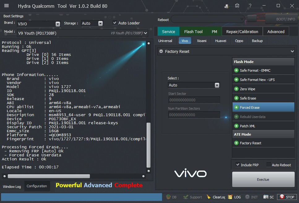

Hydra Vivo V9 Youth (PD1730BF) forced erased to remove FRP successfully done by Hydra Tool
549
1. Run Qualcomm Tool and choose "Sosc"
2. Choose Brand and Module.
3. Go to "Service"--> "Vivo"
4. Choose "Factory Reset" from drop down menu
5. Choose "Forced Erased" from Flash Mode
6. Click on "Execute"
7. Connect device to computer using USB Data Cable.
8. Wait until the operation is completed.

PreOperation Configuration
Brand : VIVO Model : V9 Youth (PD1730BF) Storage : Auto
Loader: Vivo_V9Youth-1727_PD1730BF_8953_ddr.mbn
Port : Auto
Connection :
FriendlyName :Qualcomm HS-USB QDLoader 9008 (COM22)
SymbolicName :\??\USB#VID_05C6&PID_9008#6&fbd74a4&0&2#{a5dcbf10-6530-11d2-901f-00c04fb951ed}
Getting device info..Ok
Device MODE : Firehose
Connecting to Firehose...
Ping.. Ok
Configuration......
Identifying Chip....
Ok
Chip Configuration :
MemoryName : eMMC
MaxXMLSizeInBytes : 4096
TargetName : 8953
Version : 1
*** STORAGE DEVICE INFO ***
Memory Type : eMMC
Block Size in Bytes : 512
Page Size : 512
Manufacturer ID : 21
Serial Number : 4013939962
Firmware Version : 1
Product Name : RD64MB
Physical Partitions : 3
Total Logical Blocks:
Drive [0] 61071360[29.121 GB]
Drive [1] 8192[4 MB]
Drive [2] 8192[4 MB]
Protocol : Universal
Running : Ok
Reading GPT[3]
Drive [0] 56 Items
Drive [1] 0 Items
Drive [2] 0 Items
Phone Information......
Brand : vivo
Vendor : vivo
Model : vivo 1727
SDK : 28
Release : 9
ABI : arm64-v8a
Locale : en-US
Description : msm8953_64-user 9 PKQ1.190118.001 compiler03131127 release-keys
Device : PD1730BF_EX
Display ID : PKQ1.190118.001 release-keys
Security Patch : 2021-03-01
Emmc_size : 16GB
Platform : =QCOM8953
Fingerprint : vivo/1727/1727:9/PKQ1.190118.001/compiler03131127:user/release-keys
Processing Forced Erase....
- Removing FRP [Auto] Ok
- Forced Erase Userdata
Action Result : Ok
Elapsed Time : 00:00:17
