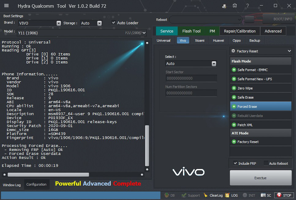

Hydra Vivo Y11 (1906) Forced Erase to remove FRP successfully done by Hydra Tool
550
Hydra Qualcomm Tool Ver 1.0.2 Build 72
Windows 10 (Version 10.0, Build 18362, 32-bit Edition)
AMD A6-7310 APUwith AMD Radeon R4 Graphics
AMD Radeon (TM) R5 M330
Ram Installed : 3 GB
Windows Access Right Admin
******* Dongle Info *******
Version : Hydra Tool v 1.1
Serial : 190600001207
Initialize : OKAY
Status : Activated
Life : 0 [0-0-0-0-0]
PreOperation Configuration
Brand : VIVO Model : Y11 (1906) Storage : Auto
Loader: Vivo_Y11.elf
Port : Auto
Connection :
FriendlyName :Qualcomm HS-USB QDLoader 9008 (COM8)
SymbolicName :\??\USB#VID_05C6&PID_9008#7&3977959&1&1#{a5dcbf10-6530-11d2-901f-00c04fb951ed}
Getting device info......
Serial No.: 0x59CE0B64
MSM ID : 0x000BF0E1, SDM439-Qualcomm Snapdragon 439
PBL Ver : 00000000
PK HASH : 60BA997FEF6DA9F05885FA11F1DD6D2A
90D052A257A09C2075D7246CC73C0D43
Firehose Loader[Vivo_Y11.elf]
SaharaBoot... Ok
Sending ...................Ok
Connecting to Firehose...
Ping... Ok
Configuration......
Identifying Chip....
Ok
Chip Configuration :
MemoryName : eMMC
MaxXMLSizeInBytes : 4096
TargetName : 8937
Version : 1
*** STORAGE DEVICE INFO ***
Memory Type : eMMC
Block Size in Bytes : 512
Page Size : 512
Manufacturer ID : 144
Serial Number : 3264912816
Firmware Version : 909127728
Product Name : hB8aP>
Physical Partitions : 3
Total Logical Blocks:
Drive [0] 61071360[29.121 GB]
Drive [1] 8192[4 MB]
Drive [2] 8192[4 MB]
Protocol : Universal
Running : Ok
Reading GPT[3]
Drive [0] 60 Items
Drive [1] 0 Items
Drive [2] 0 Items
Phone Information......
Brand : vivo
Vendor : vivo
Model : vivo 1906
SDK : 28
Release : 9
ABI : arm64-v8a
Locale : en-US
Description : msm8937_64-user 9 PKQ1.190616.001 compiler09232225 release-keys
Device : PD1930F_EX
Display ID : PKQ1.190616.001 release-keys
Security Patch : 2020-09-01
Emmc_size : 16GB
Platform : =SDM439
Fingerprint : vivo/1906/1906:9/PKQ1.190616.001/compiler09232225:user/release-keys
Processing Forced Erase....
- Removing FRP [Auto] Ok
- Forced Erase Userdata
Action Result : Ok
Elapsed Time : 00:00:19
