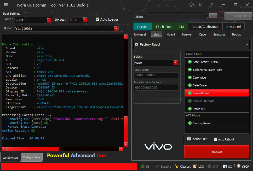

Vivo Y11 (1906) Remove Lock without loss Data using EDL method by Hydra Tool
1. Run Hydra Qualcomm Tool.
2. Choose Module and Brand.
3. Go to "Service"--> "Vivo"
4. Choose "Factory Reset" from drop down menu.
5. Choose "Forced Erased" from Flash Menu.
6. Click "Execute"
7. Tick "Include FRP"
8. Connect Cellphone with your computer using data cable.
9. Wait until the operation is completed.
6. Click "Execute"
