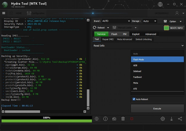

Vivo Y21 2021 V2111 Pattern and Frp Lock Remove with Hydra Tool
- Keep Press Boot Info
To Enable BROM  Mode :
     Method 1    - Bootkey (Vol + - Power) or any combination
     Method 2    - Enable Preloader to brom(crashing Method)
     Method 3    - Test Point Data0 + ground
To Enable Preloader  Mode :
     Method 1    - Just Insert cable
  MTK Port Type   : Flashmode BROM
  FriendlyName    : MediaTek USB Port_V1633 (COM57)
  Device          : /6&1ba46697&0&5
  SymbolicName    : \\?\usb#vid_0e8d&pid_0003#6&1ba46697&0&5#{a5dcbf10-6530-11d2-901f-00c04fb951ed}
  Driver Ver      : 01/22/2015,3.0.1504.0
  Service         : wdm_usb
Openning Port [COM57] Ok
Handshaking...Ok
  HwCode          : 0766 {MT6765/MT8768t}
  Hwver           : 0000
  Target config   : E5
  SBC             : 01 (True)
  SLA             : 00 (False)
  DAA             : 04 (True)
  SWJTAG          : 04 (True)
  EPP             : 00 (False)
  CERT            : 00 (False)
  MEMREAD         : 20 (True)
  MEMWRITE        : 40 (True)
  CMD_C8          : 80 (True)
  Connection      : BROM
  HW Subcode      : 8A00
  HW Subcode      : CA00
  SW Ver          : 0000
  ME_ID           : 5740246FD68DE396DADA63055AFA4FCD
  SOC_ID          : F853C025EB59CEF74492EE97D5B359E986BBC8CC4D220FFDCE7A40DF4D78ABE8
Exploiting Device...
Successfully Exploited..
Handshaking...Ok
Seeking preloader address..
Not Found
  Target config   : 00
  SBC             : 00 (False)
  SLA             : 00 (False)
  DAA             : 00 (False)
  SWJTAG          : 00 (False)
  EPP             : 00 (False)
  CERT            : 00 (False)
  MEMREAD         : 00 (False)
  MEMWRITE        : 00 (False)
  CMD_C8          : 00 (False)
  Connection      : BROM
Patching da2 ... Ok
Uploading Stage 1....
Jumping to 0x00200000 Ok 0xC0
Successfully received DA sync
  ONNECTION_AGENT : brom
  DRAM config needed for : 150100444436384D
Sending auto preloader from dump...
Hydra Auto Preloader Search Enabled..
Hydra will find compatible preloader files...
Found 11 Compatible Preloaders..
1-alcatel_OT-5028A_preloader.bin...Sending... [DRAM setup passed.] [Ok]
Sending emi data succeeded.
Uploading stage 2...
Successfully uploaded stage 2
  ERAM Size       : 0x000000000003A000-232 KB
  IRAM Size       : 0x00000000C0000000-3 GB
  EMMC RPMB Size  : 0x0000000000400000-4 MB
  EMMC USER Size  : 0x0000000747C00000-29.121 GB
  EMMC CID        : 150100444436384D420269D6C2FDB621 - DD68MB
  HW-CODE         : 0x766
  HWSUB-CODE      : 0x8A00
  HW-VERSION      : 0xCA00
  SW-VERSION      : 0x0
  CHIP-EVOLUTION  : 0x0
  DA-VERSION      : 1.0
  Speed           : high-speed
Reading Partition Table ..
Partition Count : 49
  Product        : k65v1_64_bsp
  SDK            : 30
  Release        : 11
  ABI            : arm64-v8a
  CPU abilist    : arm64-v8a,armeabi-v7a,armeabi
  Locale         : en-US
  Description    : full_k65v1_64_bsp-user 11 RP1A.200720.012 eng.compil.20230504.145730 release-keys
  Display ID     : RP1A.200720.012 release-keys
  Security Patch : 2023-05-01
  StorageType    : mtp
Reading IMEI........
IMEI1 : 8611770*********
IMEI2 : 8611770*********
Bootloader Status...
  Bootloader : Locked
Backing up Security..
- preloader(preloader.bin), 512 KB                    = Ok  [preloader_k65v1_64_bsp.bin]
  *Creating Scatter file... C:\Hydra Tool\Backup\MTKBKUP\0766_5740246FD68DE39555555FA4FCD\Auto\070723170722\6765_Android_scatter.txt
- pgpt(pgpt.bin), 32 KB                               = Ok
- nvram(nvram.bin), 64 MB                             = Ok
- nvdata(nvdata.bin), 64 MB                           = Ok
- frp(frp.bin), 1024 KB                               = Ok
- protect1(protect1.bin), 8 MB                        = Ok
- protect2(protect2.bin), 14.867 MB                   = Ok
- persist(persist.bin), 48 MB                         = Ok
- proinfo(proinfo.bin), 3 MB                          = Ok
- nvcfg(nvcfg.bin), 32 MB                             = Ok
- sec1(sec1.bin), 2 MB                                = Ok
- seccfg(seccfg.bin), 8 MB                            = Ok
- lk(lk.bin), 64 MB                                   = Ok
Backup Done!!!
Elapsed Time : 00:01:13

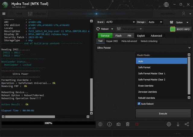

- Ultra Power >> Safeformat+FRP Remove
                      Service Function
                        Ultra Power
                            Auto
  Service         : wdm_usb
  HW-CODE         : 0x766
  HWSUB-CODE      : 0x8A00
  HW-VERSION      : 0xCA00
  SW-VERSION      : 0x0
  DA-VERSION      : 1.0
  Speed           : high-speed
  SDK            : 30
  Release        : 11
  ABI            : arm64-v8a
  Locale         : en-US
  StorageType    : mtp
IMEI1 : 86117**********
IMEI2 : 86117**********
  Bootloader : Locked
        Ultra Power
Formatting Userdata :
Operation : Safeformat Universal... Ok
Removing FRP :  Ok
Rebooting Device...
Rebooting Operation Done!!!!
Action Result :  Ok
Elapsed Time : 00:00:06

  Service         : wdm_usb
  HW-CODE         : 0x766
  HWSUB-CODE      : 0x8A00
  HW-VERSION      : 0xCA00
  SW-VERSION      : 0x0
  DA-VERSION      : 1.0
  Speed           : high-speed
  SDK            : 30
  Release        : 11
  ABI            : arm64-v8a
  Locale         : en-US
  StorageType    : mtp
  Bootloader : Locked
        Ultra Power
Removing FRP :  Ok
Rebooting Device...
Action Result :  Ok
