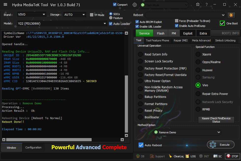

Vivo Y22 (PD1309W) Remove Demo Successfully done by Hydra Tool
1. Run Hydra MTK module.
2. Choose Brand and Module
3. Tick "ComPort"
4. Tick "Auto Broom Exploit", "Enable UBL Loader" and "Enable Auto PrelDUMP"
5. Go to "Service" -->"Tool" Tab.
6. Choose "Vivo"
7. Choose "Remove Demo" from drop down menu.
8. Tick "Auto Reboot"
9. Click "Execute"
10. connect device to the computer with USB Data cable
11. Wait until the process is completed.
