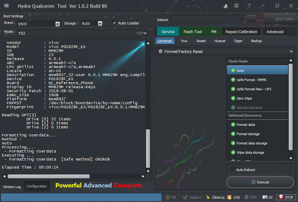

Vivo Y53 formatting user data safe method successfully done by Hydra Tool
1. Run Vivo Quacomm Tool
2. Go to "Service"--> "Universal" Tab
3. Choose "Auto" from Flash Mode
4. Click on "EXECUTE"
5. Insert Device with computer using USB Data Cable
6. Wait until the operation is completed.
7.Done.

Reading GPT[3]
Drive [0] 52 Items
Drive [1] 0 Items
Drive [2] 0 Items
Formatting Userdata...
Method :
Auto
Processing...
- Formatting Userdata
Executing ...
- Formatting Userdata [Safe method] OkOkOk
Elapsed Time : 00:00:14
