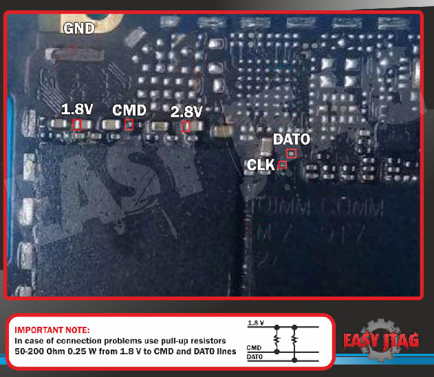

Dissassemble the phone and remove the motherboard.

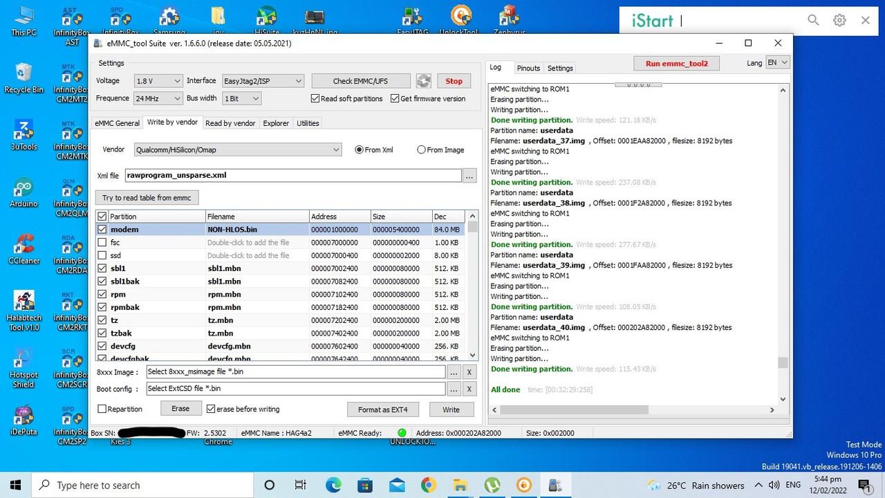

Connect 1.8V, CMD, 2.8V, CLK, DAT0 and GROUND.
Open EASY JTAG PLUS

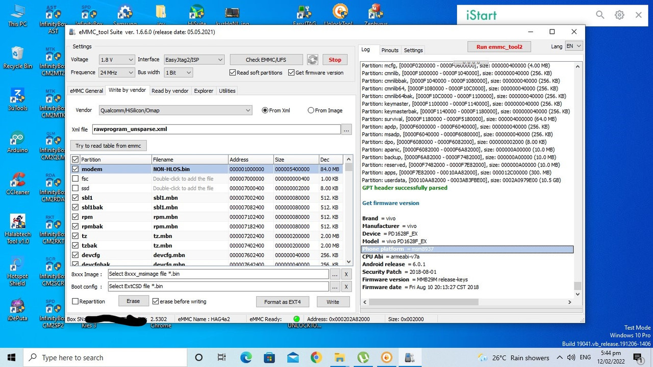

Bckup rom1,rom2 and rom3
Load Rawprogram_Unparse_xml
Click WRITE
Done.
