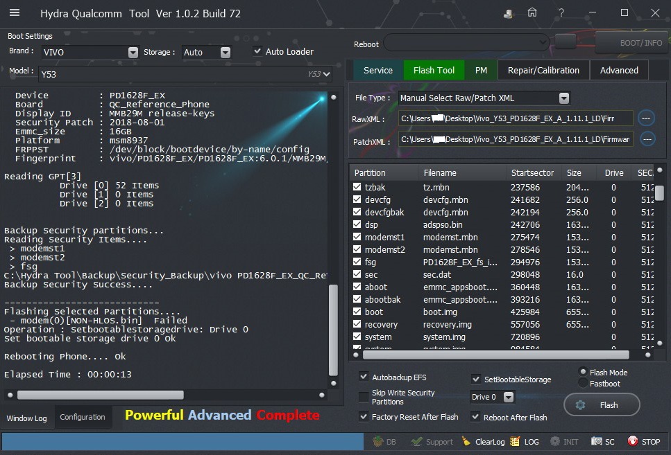

Hydra Vivo Y53 Successfully Flashed by Hydra Tool
547
FriendlyName :Qualcomm HS-USB QDLoader 9008 (COM28)
SymbolicName :\??\USB#VID_05C6&PID_9008#6&186afa3&0&1#{a5dcbf10-6530-11d2-901f-00c04fb951ed}
Driver Ver :08/31/2015,2.1.2.0
Getting device info..Ok
Device MODE : Firehose
Connecting to Firehose...
Ping.. Ok
Configuration......
Identifying Chip....
Ok
Chip Configuration :
MemoryName : eMMC
MaxXMLSizeInBytes : 4096
TargetName : 8917
Version : 1
*** STORAGE DEVICE INFO ***
Memory Type : eMMC
Block Size in Bytes : 512
Page Size : 512
Manufacturer ID : 144
Serial Number : 876796016
Firmware Version : 165
Product Name : HAG4a2
Physical Partitions : 3
Total Logical Blocks:
Drive [0] 30777344[14.676 GB]
Drive [1] 8192[4 MB]
Drive [2] 8192[4 MB]
Protocol : Universal
Running : Ok
Phone Information.....
Brand : vivo
Vendor : vivo
Model : vivo PD1628F_EX
SDK : 23
Release : 6.0.1
ABI : armeabi-v7a
Locale : en-US
Description : msm8937_32-user 6.0.1 MMB29M eng.compiler.20190105.211334 release-keys
Device : PD1628F_EX
Board : QC_Reference_Phone
Display ID : MMB29M release-keys
Security Patch : 2018-08-01
Emmc_size : 16GB
Platform : msm8937
Fingerprint : vivo/PD1628F_EX/PD1628F_EX:6.0.1/MMB29M/compiler01052117:user/release-keys
Reading GPT[3]
Drive [0] 52 Items
Drive [1] 0 Items
Drive [2] 0 Items
Backup Security partitions...
Reading Security Items....
> modemst1
> modemst2
> fsg
C:\Hydra Tool\Backup\Security_Backup\vivo PD1628F_EX_QC_Reference_Phone_6.0.1_Security_020421105738.sec
Backup Security Success....
- modem(0)[NON-HLOS.bin] Failed
Rebooting Phone.... Ok
Elapsed Time : 00:00:13
