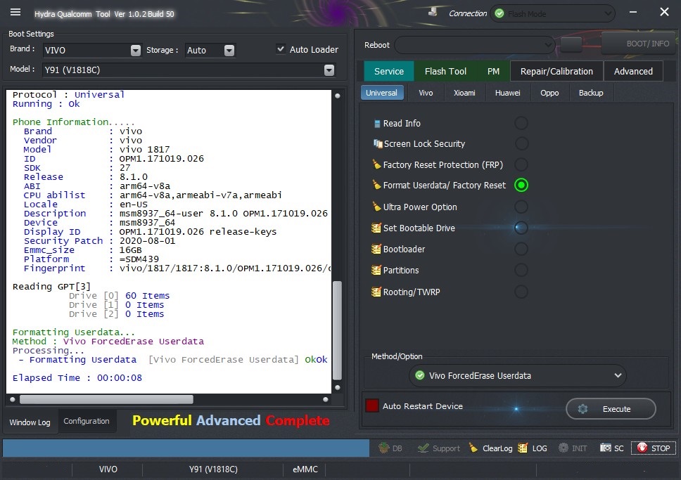

Vivo Y91 V1818C Pattern Remove Done by Hydra Dongle
PreOperation Configuration
Brand : VIVO Model : Y91 (V1818C) Storage : Auto
Loader: vivo_3_6.mbn
Port : Auto
Connection : Flash Mode
FriendlyName :Qualcomm HS-USB QDLoader 9008 (COM10)
SymbolicName :\??\USB#VID_05C6&PID_9008#6&13f92a08&0&2#{a5dcbf10-6530-11d2-901f-00c04fb951ed}
Getting device info......
Serial No.: 0xF65327BA
MSM ID : 0x000BF0E1, SDM439-Qualcomm Snapdragon 439
PBL Ver : 00000000
PK HASH : 60BA997FEF6DA9F05885FA11F1DD6D2A
90D052A257A09C2075D7246CC73C0D43
Firehose Loader[vivo_3_6.mbn]
SaharaBoot... Ok
Sending ...................Ok
Connecting to Firehose...
Ping... Ok
Configuration......
Identifying Chip....
Ok
Chip Configuration :
MemoryName : eMMC
MaxXMLSizeInBytes : 4096
TargetName : 8937
Version : 1
*** STORAGE DEVICE INFO ***
Memory Type : eMMC
Block Size in Bytes : 512
Page Size : 512
Manufacturer ID : 144
Serial Number : 995801488
Firmware Version : 165
Product Name : HAG4a2
Physical Partitions : 3
Total Logical Blocks:
Drive [0] 30777344[14.676 GB]
Drive [1] 8192[4 MB]
Drive [2] 8192[4 MB]
Protocol : Universal
Running : Ok
Phone Information.....
Brand : vivo
Vendor : vivo
Model : vivo 1817
SDK : 27
Release : 8.1.0
ABI : arm64-v8a
Locale : en-US
Description : msm8937_64-user 8.1.0 OPM1.171019.026 eng.compil.20200730.192449 release-keys
Device : msm8937_64
Display ID : OPM1.171019.026 release-keys
Security Patch : 2020-08-01
Emmc_size : 16GB
Platform : =SDM439
Fingerprint : vivo/1817/1817:8.1.0/OPM1.171019.026/compil07301924:user/release-keys
Reading GPT[3]
Drive [0] 60 Items
Drive [1] 0 Items
Drive [2] 0 Items
Formatting Userdata...
Method : Vivo ForcedErase Userdata
Processing...
- Formatting Userdata [Vivo ForcedErase Userdata] OkOk
Elapsed Time : 00:00:08
