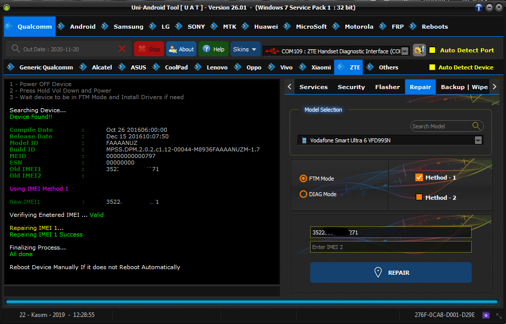

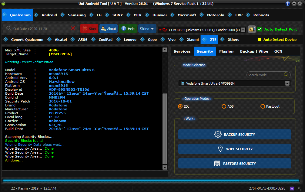

Vodafone Smart Ultra 6 VFD995N Repair IMEI by UAT
gsmgold
Jan 25, 2020
27
5
Put FTM, FTM to EDL, Wipe Security at EDL Mode Then at FTM by Port Write IMEI
