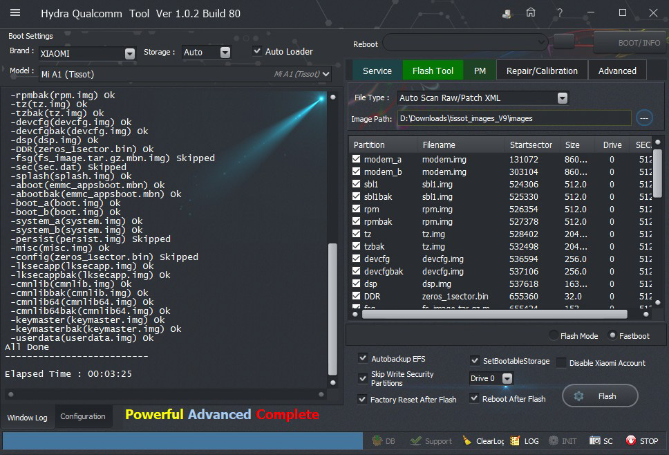

Xiaomi Mi A1 (Tissot) successfully flashed by Hydra Tool
1. Run Hydra Qualcomm Module and Sosc.
2. Choose Brand and Module.
3. Go to "Flash Tool" Tab.
4. Choose Flash file and its location.
5. Click on "Flash"
6. connect device to the computer with USB Data cable
7. Wait until the process is completed.
5. Click on "Flash"
BRSearching Device By Fastboot
Device Found...
Reading Information...version: 0.5
Product : tissot
version : 0.5
Secure : yes
Device Info:
Device tampered: false
Device unlocked: true
Device critical unlocked: true
Charger screen enabled: false
Display panel:
Fastboot Flashing...
-modem_a(modem.img) Ok
-modem_b(modem.img) Ok
-sbl1(sbl1.img) Ok
-sbl1bak(sbl1.img) Ok
-rpm(rpm.img) Ok
-rpmbak(rpm.img) Ok
-tz(tz.img) Ok
-tzbak(tz.img) Ok
-devcfg(devcfg.img) Ok
-devcfgbak(devcfg.img) Ok
-dsp(dsp.img) Ok
-DDR(zeros_1sector.bin) Ok
-fsg(fs_image.tar.gz.mbn.img) Skipped
-sec(sec.dat) Skipped
-splash(splash.img) Ok
-aboot(emmc_appsboot.mbn) Ok
-abootbak(emmc_appsboot.mbn) Ok
-boot_a(boot.img) Ok
-boot_b(boot.img) Ok
-system_a(system.img) Ok
-system_b(system.img) Ok
-persist(persist.img) Skipped
-misc(misc.img) Ok
-config(zeros_1sector.bin) Skipped
-lksecapp(lksecapp.img) Ok
-lksecappbak(lksecapp.img) Ok
-cmnlib(cmnlib.img) Ok
-cmnlibbak(cmnlib.img) Ok
-cmnlib64(cmnlib64.img) Ok
-cmnlib64bak(cmnlib64.img) Ok
-keymaster(keymaster.img) Ok
-keymasterbak(keymaster.img) Ok
-userdata(userdata.img) Ok
All Done
Elapsed Time : 00:03:25
