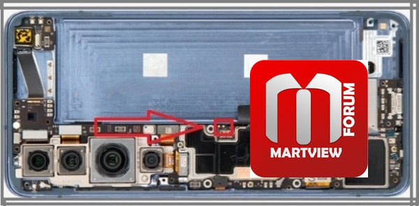

Xiaomi Mi 10 Pro Run on Android 10 & it is Powered by QCOM Snapdragon 865 Processor. it is a Dual SIM (GSM) Smartphone that Support Nano-SIM Cards. Connectivity options include, Bluetooth,, USB OTG, FM, 3G 4G & 5G. The device Come with 8GB of RAM and 256GB of Storage can be expandable via SD card.
  • Install QD Loader Driver on PC
  • Remove back Cover of Phone
  • Find out The Pinout as Show In Image
  • Connect Phone to PC with usb Cable
  • take a Coper Wire and Short that Pinout
