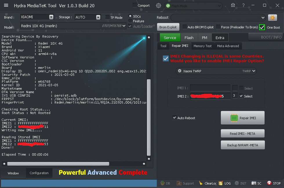

Xiaomi Redmi 10X 4G Second IMEI successfully repaired by Hydra Tool
1. Run Hydra MTK Module, Select Brand and Model
2. Go to Service-->Repair IMEI
3. Choose "Xiaomi Twarp" from drop down menu
4. Type correct IMEI as written in battery housing
5. Execute and connect the device to the computer
6. wait until the process is completed.[/LEFT
Screen Short:2. Go to Service-->Repair IMEI
BR=====================================
***IMEI REPAIR FUNCTION****
Xiaomi TWRP
Searching Device By Recovery
Device Found...
Model : Redmi 10X 4G
Brand : Xiaomi
Android Ver : 11
CPU abi : arm64-v8a
Software Version :
CSC Version :
Bootloader :
Board : merlin
Display ID : omni_redmi10x4G-eng 10 QQ1D.200205.002 eng.wzsx15.20210109.125413 test-keys
Security Patch : 2021-03-05
Emmc_size :
Platform : mt6768
Kernel ID : 2021-03-05
Marketname :
OTA Version Name :
SYS USB CONFIG : persist.adb
FRPPST : /dev/block/platform/bootdevice/by-name/frp
FingerPrint : Redmi/merlin/merlin:11/RQ2A.210305.006/1015:userdebug/release-keys
Checking Root Status....
Root Status : Not Rooted
Current IMEI:
IMEI1 : FFFFFFFFFFFFFFF
IMEI2 : ***************11
Writing new IMEI....
Reading Stored IMEI
IMEI2 : ***************53
Done!!
Elapsed Time : 00:00:06
