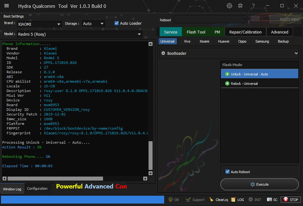

Xiaomi Redmi 5 (Rosy) unlock bootloader successfully done by Hydra Tool
1. Run Hydra MTK Module,
2. Select Brand and Model or AUTO
Note: If Auto boot and loader not supported, then, untick "Autoloader" and choose manual Da (download agent) and PERL (boot file).
3. Tick "Enable UBL Loader"
(Note: You can use this option if it the device does not boot properly by Hydra Tool)
4. click on "Read System Info"
5. Connect device to computer using USB Data Cable.
6. Wait Hydra Reads all device information properly.
6. Go to "Service"-->Xiaomi
7. Choose "Bootloader" from drop down menu.
8. Choose "Unlock Universal Auto".
9. Click on "Execute"
10. Wait until the operation is completed.
