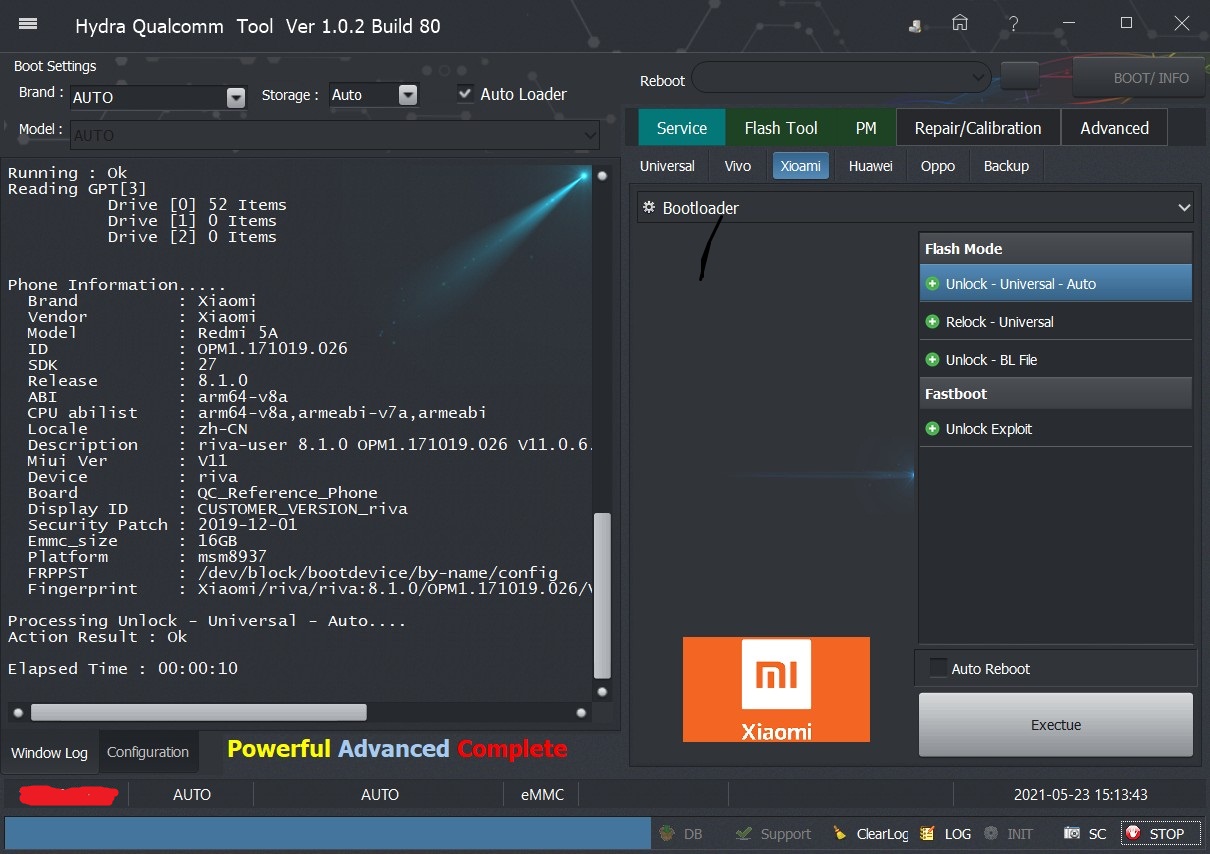

Xiaomi Redmi 5A Bootloader unlock successfully done by Hydra Tool​
1. Run Hydra Qualcomm Module and choose "Sosc"
2. Select Brand and Model as "Auto"
3. Go to Service-->Xiaoami
4. Choose "Bootloader" from drop down menu
5. Choose "Unlock Universal Auto"
6. Execute and connect the device to the computer with data cable
7. wait until the process is completed.
Screen Shorts
Logs​
PreOperation Configuration
Brand : AUTO Model : AUTO Storage : Auto
Loader: Auto
Port : Auto
Connection :
FriendlyName :Qualcomm HS-USB QDLoader 9008 (COM3)
SymbolicName :\??\USB#VID_05C6&PID_9008#6&cecaa65&0&3#{a5dcbf10-6530-11d2-901f-00c04fb951ed}
Driver Ver :05/29/2019,2.1.3.7
Getting device info......
Serial No.: 0x73042355
MSM ID : 0x000560E1, MSM8917-Qualcomm Snapdragon 425
PBL Ver : 00000000
Firehose Loader[Redmi_8917.mbn]
SaharaBoot... Ok
Sending ...................Ok
Connecting to Firehose...
Ping... Ok
Configuration......
Identifying Chip....
Ok
Chip Configuration :
MemoryName : eMMC
MaxXMLSizeInBytes : 4096
TargetName : 8917
Version : 1
*** STORAGE DEVICE INFO ***
Memory Type : eMMC
Block Size in Bytes : 512
Page Size : 512
Manufacturer ID : 144
Serial Number : 3347070504
Firmware Version : 165
Product Name : HBG4a2
Physical Partitions : 3
Total Logical Blocks:
Drive [0] 61071360[29.121 GB]
Drive [1] 8192[4 MB]
Drive [2] 8192[4 MB]
Protocol : Universal
Running : Ok
Reading GPT[3]
Drive [0] 52 Items
Drive [1] 0 Items
Drive [2] 0 Items
Phone Information.....
Brand : Xiaomi
Vendor : Xiaomi
Model : Redmi 5A
SDK : 27
Release : 8.1.0
ABI : arm64-v8a
Locale : zh-CN
Description : riva-user 8.1.0 OPM1.171019.026 V11.0.6.0.OCKCNXM release-keys
Miui Ver : V11
Device : riva
Board : QC_Reference_Phone
Display ID : CUSTOMER_VERSION_riva
Security Patch : 2019-12-01
Emmc_size : 16GB
Platform : msm8937
Fingerprint : Xiaomi/riva/riva:8.1.0/OPM1.171019.026/V11.0.6.0.OCKCNXM:user/release-keys
Processing Unlock - Universal - Auto....
Action Result : Ok
Elapsed Time : 00:00:10
