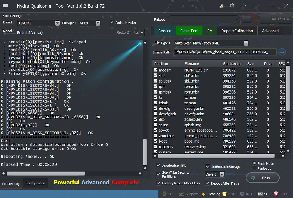

Xiaomi Redmi 5A (riva) successfully flashing done by Hydra Tool
FriendlyName :Qualcomm HS-USB QDLoader 9008 (COM16)
SymbolicName :\??\USB#VID_05C6&PID_9008#6&12e3c9ed&0&1#{a5dcbf10-6530-11d2-901f-00c04fb951ed}
Driver Ver :08/31/2015,2.1.2.0
Getting device info......
Serial No.: 0x48A6C3DA
MSM ID : 0x000560E1, MSM8917-Qualcomm Snapdragon 425
PBL Ver : 00000000
Firehose Loader[mi_1_8.mbn]
SaharaBoot... Ok
Sending ...................Ok
Connecting to Firehose...
Ping... Ok
Configuration......
Identifying Chip....
Ok
Chip Configuration :
MemoryName : eMMC
MaxXMLSizeInBytes : 4096
TargetName : 8917
Version : 1
*** STORAGE DEVICE INFO ***
Memory Type : eMMC
Block Size in Bytes : 512
Page Size : 512
Manufacturer ID : 21
Serial Number : 250139327
Firmware Version : 1
Product Name : GD6BMB
Physical Partitions : 3
Total Logical Blocks:
Drive [0] 61071360[29.121 GB]
Drive [1] 8192[4 MB]
Drive [2] 8192[4 MB]
Protocol : Universal
Running : Ok
Phone Information.....
Brand : Xiaomi
Vendor : Xiaomi
Model : Redmi 5A
SDK : 25
Release : 7.1.2
ABI : arm64-v8a
Locale : en-GB
Description : riva-user 7.1.2 N2G47H V9.5.10.0.NCKMIFA release-keys
Miui Ver : V9
Device : riva
Mod_device : riva_global
Board : QC_Reference_Phone
Display ID : N2G47H
Security Patch : 2018-05-01
Emmc_size : 16GB
Platform : msm8937
Fingerprint : Xiaomi/riva/riva:7.1.2/N2G47H/V9.5.10.0.NCKMIFA:user/release-keys
Reading GPT[3]
Drive [0] 52 Items
Drive [1] 0 Items
Drive [2] 0 Items
Backup Security partitions...
Reading Security Items....
> modemst1
> modemst2
> fsg
C:\Hydra Tool\Backup\Security_Backup\Redmi 5A_QC_Reference_Phone_7.1.2_Security_022621102354.sec
Backup Security Success....
- modem(0)[NON-HLOS.bin] Ok
- sbl1(0)[sbl1.mbn] Ok
- sbl1bak(0)[sbl1.mbn] Ok
- rpm(0)[rpm.mbn] Ok
- rpmbak(0)[rpm.mbn] Ok
- tz(0)[tz.mbn] Ok
- tzbak(0)[tz.mbn] Ok
- devcfg(0)[devcfg.mbn] Ok
- devcfgbak(0)[devcfg.mbn] Ok
- dsp(0)[adspso.bin] Ok
- splash(0)[splash.img] Ok
- boot(0)[boot.img] Ok
- system(0)[system.img] Ok
- cache(0)[cache.img] Ok
- misc(0)[misc.img] Ok
- cmnlib(0)[cmnlib_30.mbn] Ok
- cmnlibbak(0)[cmnlib_30.mbn] Ok
- keymaster(0)[keymaster.mbn] Ok
- keymasterbak(0)[keymaster.mbn] Ok
- cust(0)[cust.img] Ok
0 [NUM_DISK_SECTORS-34.] OK
0 [NUM_DISK_SECTORS-1.] OK
0 [NUM_DISK_SECTORS-33.] OK
0 [CRC32(2,6656)] OK
0 [CRC32(NUM_DISK_SECTORS-33.,6656)] OK
0 [0] OK
0 [CRC32(1,92)] OK
0 [0] OK
Done!
Rebooting Phone.... Ok
Elapsed Time : 00:08:29
