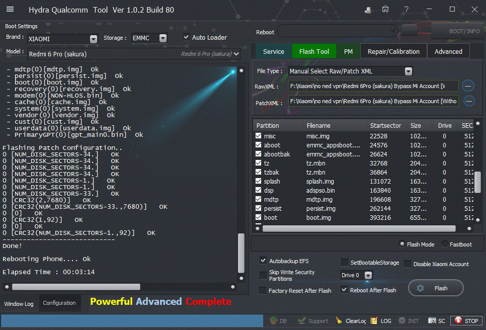

Xiaomi Redmi 6 Pro (Sa.Ku.Ra.) Successfully flashed by Hydra Tool
1. Run Hydra Qualcomm Module and Sosc.
2. Choose Brand and Module.
3. Go to "Flash Tool" Tab.
4. Choose Flash file and its location.
5. Click on "Flash"
6. connect device to the computer with USB Data cable
7. Wait until the process is completed.
5. Click on "Flash"
BRSearching for Qualcomm 9008 Device...Found
FriendlyName :Qualcomm HS-USB QDLoader 9008 (COM49)
SymbolicName :\??\USB#VID_05C6&PID_9008#6&265d47d&0&2#{a5dcbf10-6530-11d2-901f-00c04fb951ed}
Driver Ver :
Getting device info......
Serial No.: 0x17F2831E
MSM ID : 0x000460E1, MSM8953-Qualcomm Snapdragon 625
PBL Ver : 00000000
Firehose Loader[Xiaomi_Remi 6 pro_******_8953_ddr.mbn]
SaharaBoot... Ok
Sending ....................Ok
Connecting to Firehose...
Ping... Ok
Configuration.
Signature Request -> bob[DPP5qdsDzvIg7UbM0ssFhmPVm8G]
- Hydra Is Online
Signature @256bytes Authentication.... Accepted......
Ok
Chip Configuration :
MemoryName : eMMC
MaxXMLSizeInBytes : 4096
TargetName : 8953
Version : 1
*** STORAGE DEVICE INFO ***
Memory Type : eMMC
Block Size in Bytes : 512
Page Size : 512
Manufacturer ID : 69
Serial Number : 2516084797
Firmware Version : 2314907615826620721
Product Name : DL2032
Physical Partitions : 3
Total Logical Blocks:
Drive [0] 61071360[29.121 GB]
Drive [1] 8192[4 MB]
Drive [2] 8192[4 MB]
Protocol : Universal
Running : Ok
Phone Information.....
Brand : xiaomi
Vendor : Xiaomi
Model : Redmi 6 Pro
SDK : 27
Release : 8.1.0
ABI : arm64-v8a
Locale : zh-CN
Description : ******-user 8.1.0 OPM1.171019.019 V10.0.5.0.ODICNFH release-keys
Miui Ver : V10
Device : ******
Display ID : ZQL1715-******-build-20181019192740
Security Patch : 2018-10-05
Emmc_size : 16GB
Fingerprint : xiaomi/******/******:8.1.0/OPM1.171019.019/V10.0.5.0.ODICNFH:user/release-keys
Reading GPT[3]
Drive [0] 60 Items
Drive [1] 0 Items
Drive [2] 0 Items
Backup Security partitions...
Reading Security Items....
> modemst1
> modemst2
> fsg
C:\Hydra Tool\Backup\Security_Backup\Redmi 6 Pro__8.1.0_Security_050421100057.sec
Backup Security Success....
- sec(0)[sec.dat] Ok
- config(0)[config.bin] Ok
- lksecapp(0)[lksecapp.mbn] Ok
- lksecappbak(0)[lksecapp.mbn] Ok
- devcfg(0)[devcfg.mbn] Ok
- devcfgbak(0)[devcfg.mbn] Ok
- apdp(0)[dummy.img] Ok
- msadp(0)[dummy.img] Ok
- sbl1(0)[sbl1.mbn] Ok
- sbl1bak(0)[sbl1.mbn] Ok
- rpm(0)[rpm.mbn] Ok
- rpmbak(0)[rpm.mbn] Ok
- cmnlib(0)[cmnlib_30.mbn] Ok
- cmnlibbak(0)[cmnlib_30.mbn] Ok
- cmnlib64(0)[cmnlib64_30.mbn] Ok
- cmnlib64bak(0)[cmnlib64_30.mbn] Ok
- keymaster(0)[keymaster64.mbn] Ok
- keymasterbak(0)[keymaster64.mbn] Ok
- misc(0)[misc.img] Ok
- tz(0)[tz.mbn] Ok
- tzbak(0)[tz.mbn] Ok
- splash(0)[splash.img] Ok
- dsp(0)[adspso.bin] Ok
- mdtp(0)[mdtp.img] Ok
- persist(0)[persist.img] Ok
- boot(0)[boot.img] Ok
- modem(0)[NON-HLOS.bin] Ok
- cache(0)[cache.img] Ok
- system(0)[system.img] Ok
- vendor(0)[vendor.img] Ok
- cust(0)[cust.img] Ok
0 [NUM_DISK_SECTORS-34.] OK
0 [NUM_DISK_SECTORS-1.] OK
0 [NUM_DISK_SECTORS-33.] OK
0 [CRC32(2,7680)] OK
0 [CRC32(NUM_DISK_SECTORS-33.,7680)] OK
0 [0] OK
0 [CRC32(1,92)] OK
0 [0] OK
Done!
Rebooting Phone.... Ok
Elapsed Time : 00:03:14
