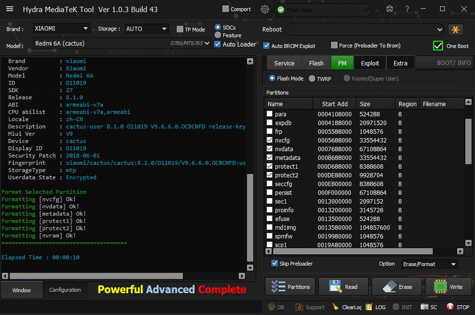

Hydra Xiaomi REdmi 6A (Cactus) formatted selected partition successfully done by Hydra Tool
550
Xiaomi Redmi 6A (Cactus) formatted selected partition successfully done by Hydra Tool
1. Run Hydra MTK Module, Select Brand and Model
2. Go to Service-->"PM" Tab
3. Choose "Flash Mode"
4. Choose "Read Partition"
5.Click on "Read" button
6. Connect the device to the computer using data cable and wait.
7. Now, choose the selected partition to format like here nvdata etc.
8. Click on "Erase"
9. wait until the process is completed.
