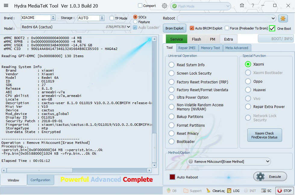

Xiaomi Redmi 6A (Cactus) Mi Account Successfully Removed using Erased Method by Hydra
1. Run Hydra MTK Module, Select Brand and Model
2. Go to Service-->Tools-->Xiaoami
3. Choose "Remove Mi Account Erased Method" from Method / Option
4. Execute and connect the device to the computer with data cable
5. wait until the process is completed.

Operation : Remove MiAccount[Erase Method]
Processing...
-persist.bin[0x0F000000]64 MB ->persist.bin...Ok
-frp.bin[0x05588000]1024 KB ->frp.bin...Ok Ok
Elapsed Time : 00:01:12
